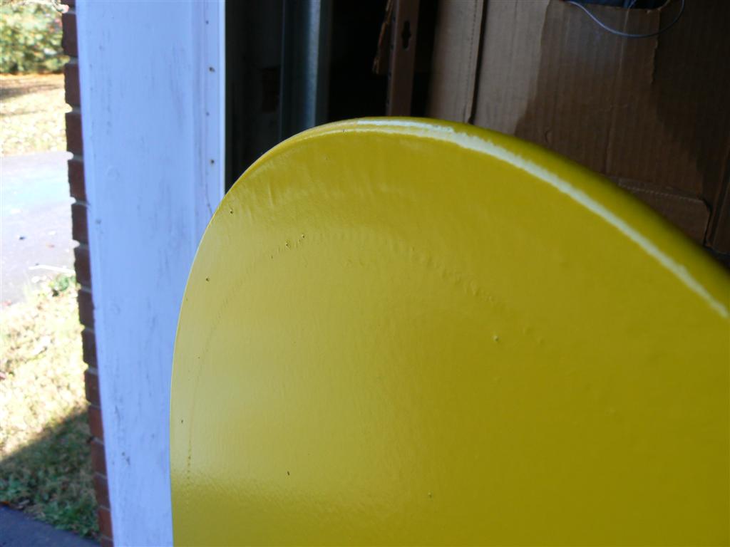

I am in the process of recovering some of the components on my FireStar. I don't recall how I did the rudder the first time (it's been more than 16 years ago) but I am having trouble. I'm using the Poly-Fiber process.
Attempting to use one piece of fabric, I glued one edge to the L.E. spar, wrapped it around the trailing edge and back to the L.E. spar and glued it in place. Now I have a lot of fabric at both the top and bottom, where the rudder is curved and I don't know how to handle it.
It looks like if I glue one of the fabric sides to the curved tubing and cut off the excess, then I would wrap the other side over it, but there is so much fabric I don't think the iron could shrink it enough to get rid of the wrinkles. Also, where the fabric wraps around the small diameter trailing edge, even to cut the one side to wrap down onto the tube for gluing becomes close to the other side, almost like a slit to separate the two, which would almost make a place where it could come apart. I thought about using two separate pieces of fabric and after installing them, run a 2 or 3 inch tape on the TE.

Here's how I did this rudder early this summer: I cut the fabric just like you did. At the top curve, I cut the fabric so that I had a good overlap and then cut a bunch of slits in it as I wrapped the first side of fabric around the small diameter tube and used lots of glue to tack it in tight. I didn't worry about the fabric from the first side laying back on itself on the inside, a little MEK laid onto the surface of the fabric as you iron it out will make it disappear.
Then the second side was wrapped around and also had a lot of slits cut into it, you overlay one little width of slit fabric over it's neighbor as you work your way around the corner.
Then you cover it with bias ply tape, I think I used 4" width to get plenty of overlap. You can pull or stretch the bias ply as you lay it on and it will conform nicely. The iron will take care of any details.
You can sort of see the overlapped and slit fabric under the curved bias tape in the photo. (There are lots of bugs in the paint because little growing Firestars need their protein)
