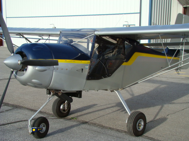

You mean like these 4" bubbles?
Model I custom bubble doors

Steve Wilson
Huntsville, UT
Kitfox Model 1- 85DD
912A / 3 Blade Warp Drive
Convertible Nosewheel & Tailwheel

Steve,
That looks like the ones I saw on the Model II at the Carleton Place, Ontario fly-in back in Sept. Am interested in using them on my Model II if they fit.

The bubble doors on my Kitfox III came from LP Aero Plastics.

Ken,
I have made the cabin wider on the model 2 by making the doors like the model 4 doors. The tubes in the middle of door can be replace with longer ones with a bend in them outwards, Re skin with 1/16 lexan.
I likely got pics here some where -- I think it adds about 3 or 4 inches to cabin width and cost for materials under 100$
