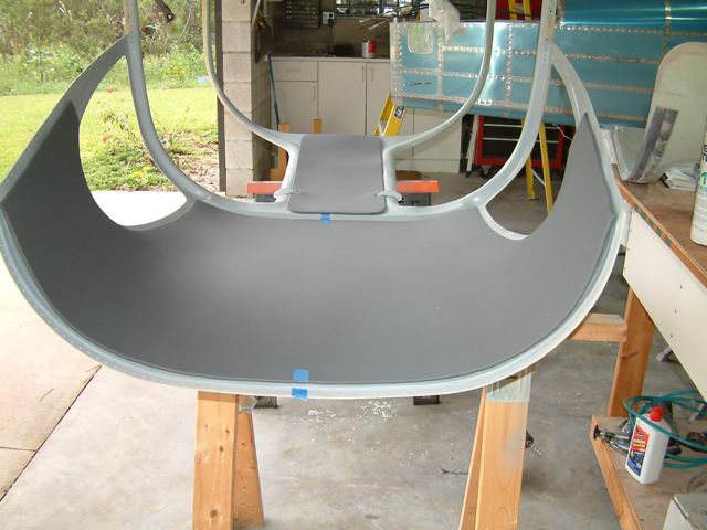

I used a headliner that had a 1/4" thick foam backing. Cut the backing about 1/2" from the edge and folded it to create a finished edge. I then glued the headliner to the plane without going over sharp turn and corners creating panels instead of covering the entire exposed cabin.
It looks good but it is not a Cirrus interior.

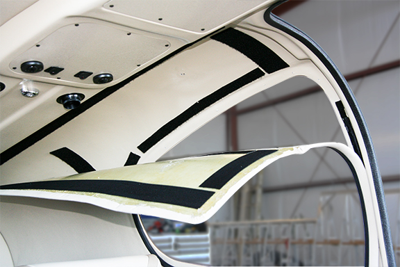

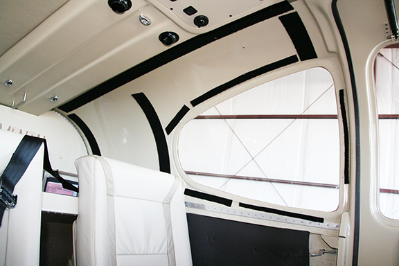

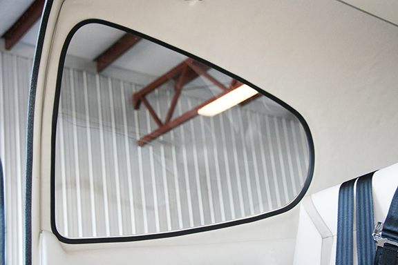

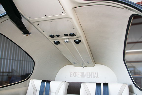

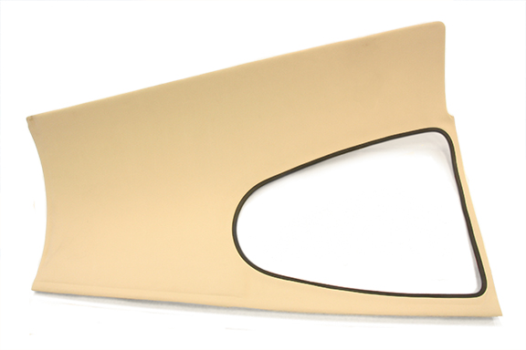

some simple trimming
And fitting to install. They are designed to be held in with Velcro, rear
bulk head cover, front
Shoulder belt attach bolt and our interior side panels if you have but not
necessary. It is designed
To be covered with automotive headliner material which comes in many
different colors. This is a thin foamed
Back material the wraps the fiberglass piece very easily. You could also use
a material of your choice.
We will have a video on how to wrap your fiberglass parts once trimmed to
fit. At this time this is designed
Just to cover from the back of the door back. See photos. You will not need
to have a overhead console
To install. We will offer it as a one piece or 2 piece option for people
without overhead consoles. It also
Trims the window opening out very nice. This can be installed in flying
aircraft as well.
For more Information please contact Aerosport Products.
Geoff Combs
www.aerosportproducts.com
