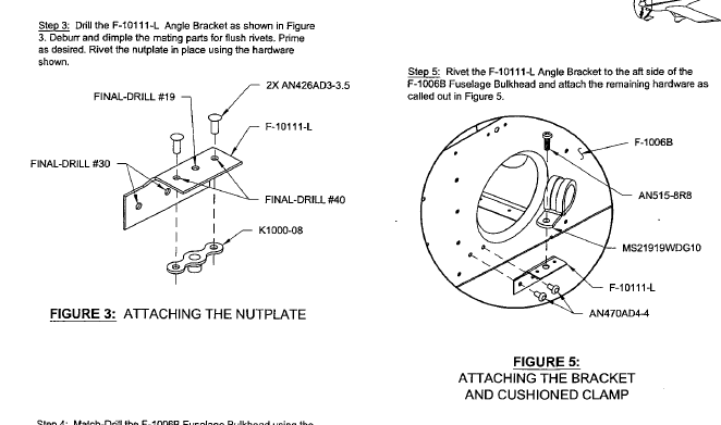

I’m not sure what you mean by lightening hole wire ties. There are wire ties, but none are specific for holes. I prefer adel clamps and lacing, but you’ll find folks that are just as satisfied with nylon wire ties. There should be plenty in the archives debating the merit of both approaches and using wire ties firewall forward. There is also a special grommet edging for the holes to protect wiring from rubbing. (http://www.aircraftspruce.com/catalog/appages/grommetedging.php) For bringing wires through holes, I prefer using F-10111 (-R-L) and an adel clamp. You can order the F-10111 from Vans or simply make your own. I’ve included an excerpt from the plans that you probably don’t have yet (OP37-11) to show you.
