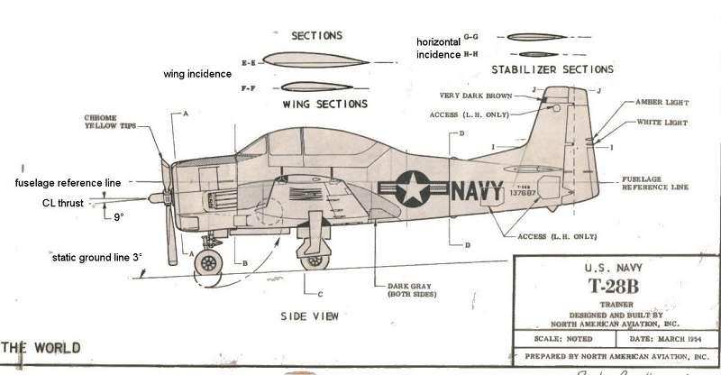

Some planes have a lot of engine down thrust. See attached. The Corsair, Grumman Wildcat and Hellcat all have a large down thrust.
