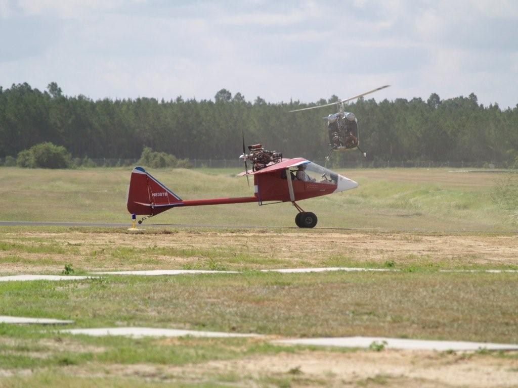

I am going to jump in here because I believe the SS has the engine thrust
line too far back. I hope you get this pic of my SS with the 912. The 582
had about the same thrust line as my 912 only adjusted for the power. If
you dont raise the back of the engine on the mount you will be virtually
pushing the nose over. The entire airframe will be fighting. You MUST
raise the rear mounts from 3/4 to maybe 7/8 of an inch (one guy went more
than that) in order to correct the angle of attack. I bet you have a really
heavy stick or a lot of bungee stretch to compensate. At 7/8 at the rear of
the mounts, you will be able to fly virtually hands off at your regular
cruise rate and not have to fight it on take off. I bet you got a handful
when you firewall the engine at take off. Not just my opinion, fact on this
one and if you dont believe, well, fight it in the air. Raise the rear of
the engine a little at a time and you will see the difference in the first
quarter inch. You will notice the angle of the blade in relation to the
boom. This really works. Trust me. Ted Cowan, Slingshot, 912UL, zoom zoom
 Filesize:  88.64 KB
 Viewed:  16415 Time(s)

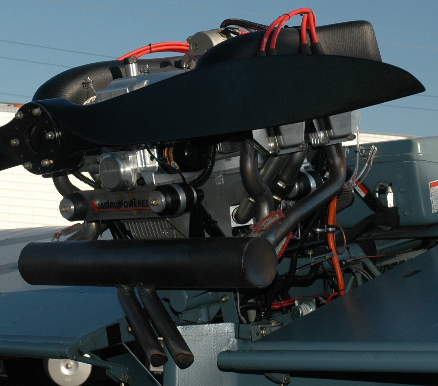

Ted,
You are correct regarding full power take-off. It becomes a handful quickly so I don't add full power until I'm airborne, and then only gradually.
I guess I'll try a little at a time as others have suggested but will probably end up with about what you have. My concern is that the Jabiru mount is a steel pad virtually identical in size to the steel pad on the Kolb and is 2 or 3 inches square or perhaps larger. So it is not like the Rotax that have vertical bolts through the slightly flexible Lord mounts. It is steel to steel which means I will need tapered shims. The Lord mounts have horizontal bolts between the steel tubing Jabiru mount and the Jabiru engine which you can see clearly in one or two of Chris's photos, and in the attached photo from my SS.
This is why it is not just a matter of simply inserting washers. If it was that simple it would have been done long ago.
 Filesize:  392.71 KB
 Viewed:  16393 Time(s)
