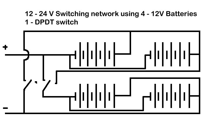

Here's a subject I have not seen discussed, as of yet, on the list or in Bob's Aero-Electric Connection:
We would like to construct a 12 volt, 24 volt, and 110 volt ground power cart for powering electrical tools, etc. and for jumping our club airplanes during the winters here in the wilds of Jersey. We have non-electrified outdoor tiedown spots.
It would seem (2) 12 volt automotive batteries in series would be inexpensive and we would keep them charged via simple 12v solar chargers mounted on top of our storage shed. The 24V charging/inverting devices are hundreds of dollars.
So how might such a circuit look to "isolate" the batteries for 12 volt charging and occasional 120v inverter usage from the 12v side and still allow on-demand 24/28V "jumping"?
My thinking says manually isolate the 24v series circuit until I want to "jump" and just throw a switch to go 24v with everything else physically disconnected. Or is there a more elegant solution?  Idiot proof would be best, remember these are pilots !!!
I have thought about this for some months but see no simple solution to provide this "isolation" function but then I am a BSCS, not an EE.
Thanks... Ed

PostPosted: Sat Oct 23, 2010 5:40 pm    Post subject: Ground Power / Tiedown Power Cart Reply with quote
I hope this little diagram I just drew will help you. Just be sure to close the SPDT switch in the 12V position before charging. The drawing is for two sets of 12 V batteries wired into two sets of 12V. For this set up I would try to get batteries of matching amperage. You can add as many batteries as you want but I was thinking that four automotive storage batteries would be heavy enough for carting around.
Noel

I've had occasion to observer or participate in the
fabrication of several battery carts over the years.
Functionally, it's not a big deal except for that
pesky DPDT switch that has to carry many hundreds
of amps. You can synthesize the switch from an array
of contactors but there is risk for shorting out one
of the batteries if a contactor sticks.
The simplest and least risky 12/24 switching involved
changing some jumpers around on a sort of "stud panel"
where the jumpers were brass bars held on threaded
studs with large hand operated "nuts" . . . but
the loose bars and exposed studs offered some slight
risk of shorts . . . about he same degree of risk
as for swinging wrenches on car battery (+) terminals.
I've been pondering a design for a jumper bar assembly
where the bars are sandwiched between two sheets
of insulating material. The spacing of the studs
is such that the array cannot be installed in any
way except one that produces the 12/24 configuration.
I'll publish the drawings in a day or so. Had them
about done tonight but had to halt operations
long enough to restore a c-drive.

* I've had occasion to observer or participate in the
I've been pondering a variation on that idea

Hi All-
You know, the thing that would make the 12 - 24v battery cart zippy would be a DPDT knife switch cabable of handling cranking currents. It would handle the switching function elegantly, and if mounted in a recess or under a cover would be pretty darn safe from accidental shorts. I've not looked yet, but I wonder if such a thing is still available, especially in some sort of surpluss house...
Glen Matejcek
mdnanwelch7(at)hotmail.co
PostPosted: Mon Oct 25, 2010 7:26 am    Post subject: Ground Power / Tiedown Power Cart Reply with quote
Glen Matejcek
Glen,
  You mean like this;
http://www.wirthco.com/12/24-volt-heavy-equipment-switch-p-66-l-en.html
  Although it isn't configured exactly yet, it wouldn't be but a very minor mod to make it so.
  I think you are right.  This would be a very simple solution!!
Mike Welch
PostPosted: Mon Oct 25, 2010 7:33 am    Post subject: Ground Power / Tiedown Power Cart Reply with quote
> Glen Matejcek
Glen,
  On second examination, yes the switch IS configured correctly right out of the box.  I see where they
make the second set of contacts to go through the handle itself!!  Clever!
Mike
