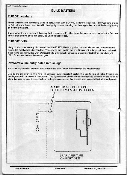

Graeme
Attached (I hope) is a page from what I believe was the final ¨Europa
News¨ from the old Company.
Lance Sandford in OZ

Hi Graeme
If you follow the workshop manual then the entry points for the Pitot/Static tube
Are self explanatory, A gentle curve to the front of the spar with entry between the spar and  forward pins,  It will be well away from any hard points,
Ivor
Pitot/static tube
Drill two 1/4” diameter holes through the port fuselage side midway between the forward wing
socket and the spar opening, making sure to keep them away from the seat belt mounting. These
holes are for the pitot/static tubes.
When rigging the aircraft the tubes will be led over the top of the spar tang
Page 27 - 22 Issue 2 Europa Build Manual
