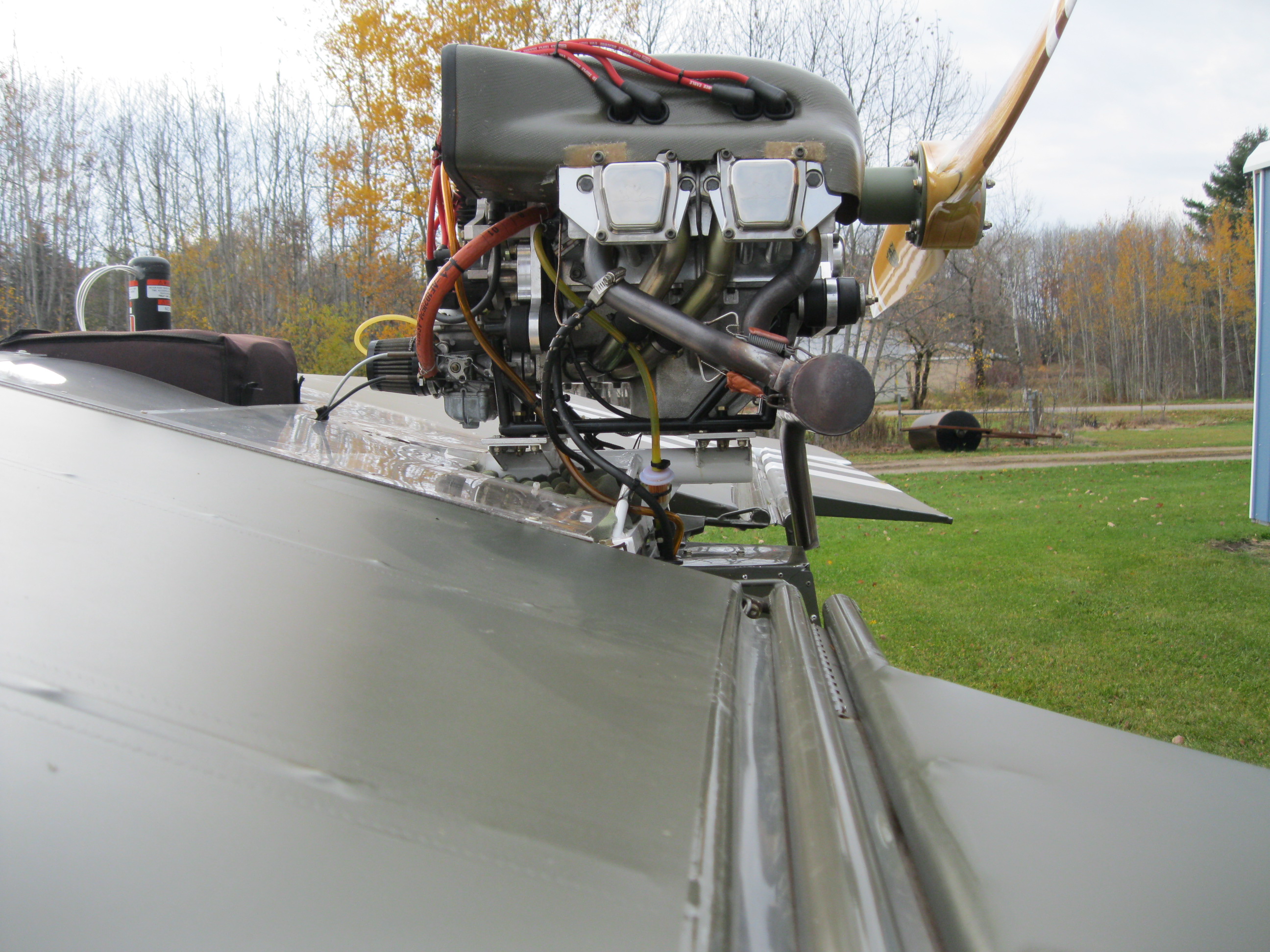

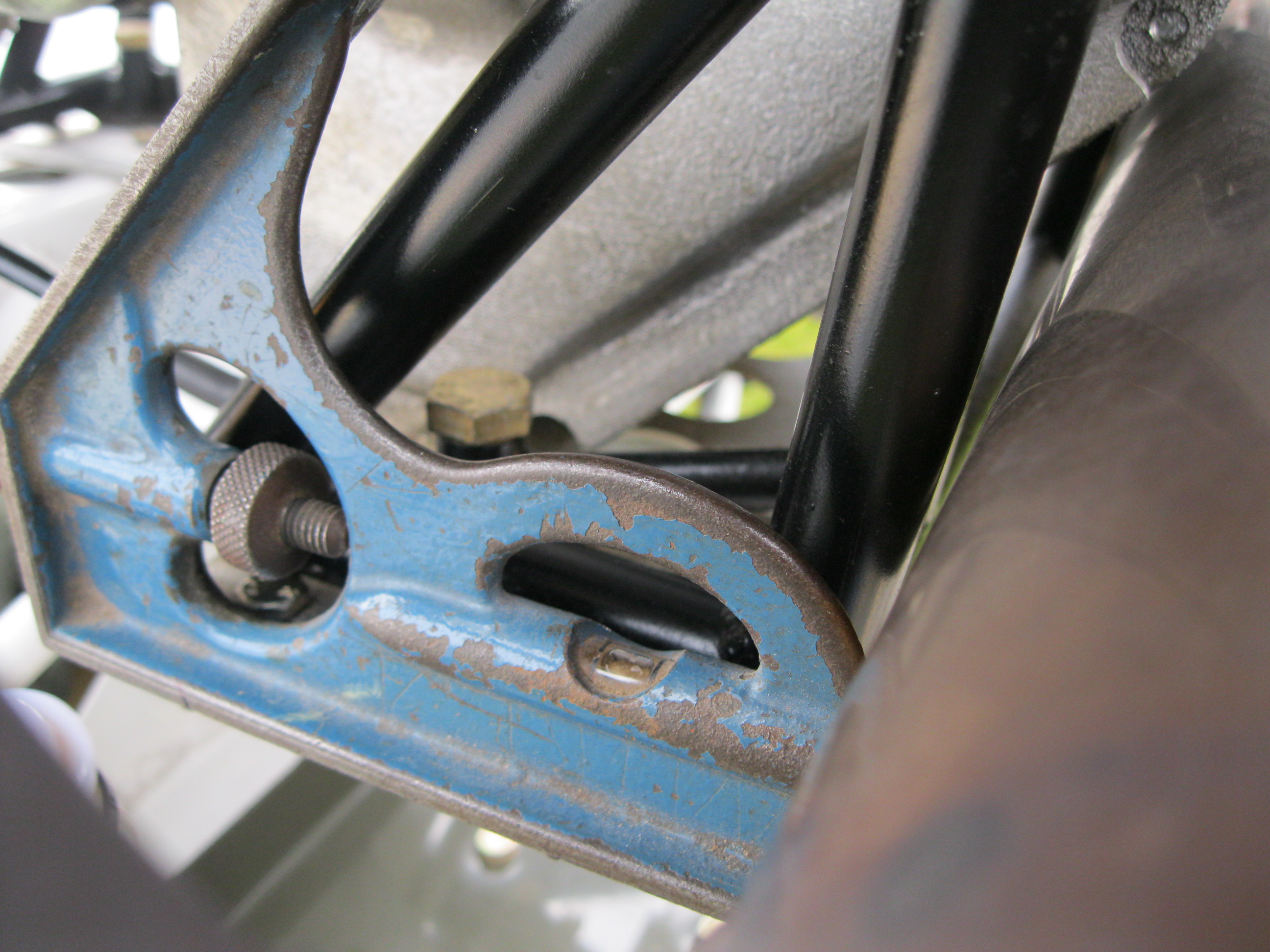

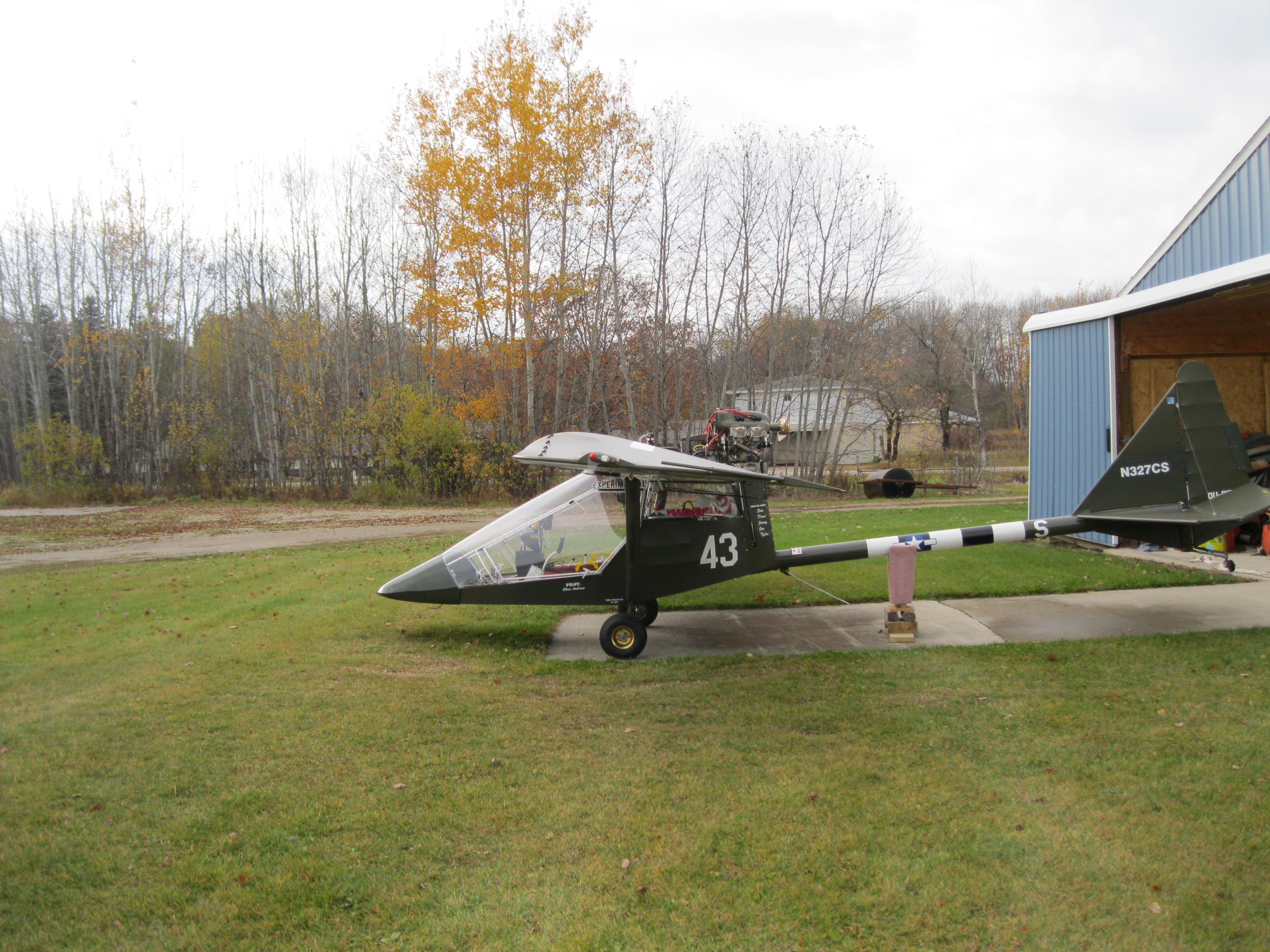

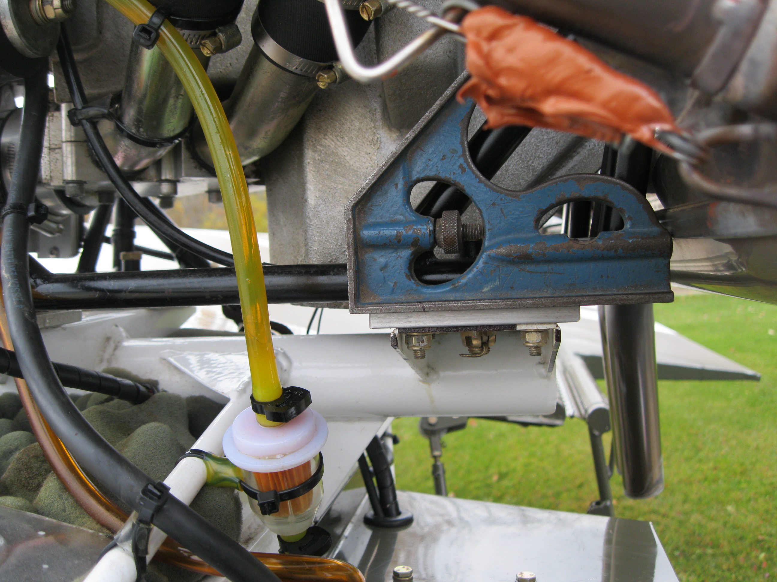

The engine is level with the factory engine mount....hopefully a picture is worth a thousand words...let me know if there is anything else I can help you with,....
chris ambrose

Thanks for the photos which shows the engine with its thrust line parallel to the ground. It is apparent from the photos that if you extend the centerline of the engine forward and the bottom of the wing forward that these two would intersect. I'm looking for this angle between them. On my SS, this angle DIVERGES instead of coming together and there is lies the problem, I believe. I'd like to get it close to right on the first attempt to adjust this angle.

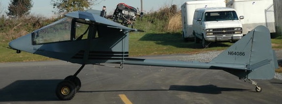

The only photo I have of the SS directly from the side is a relatively low res photo, which I've attached. It does not show very well but here is the measured data.
With the airplane sitting in 3-point stance....
Tail Boom = 5 degrees (front higher)
Horizontal Stabilizer = 5 deg. (front higher) parallel to boom
Wing Bottom = 12 degrees
Engine Thrust Line = 15.5 degrees
Therefore, relative to the Horizontal Stabilizer....
Wing Bottom has a 7 degrees incidence (12 - 5)
Engine Thrust line has 10.5 degrees incidence (15.5 -5)
The engine thrust line points higher (in front) than the wing bottom by 3.5 degrees!

I see what you mean ...your thrust line and wing incidence are about parallel if you draw a line down the center of the crank and the bottom of the wing...
