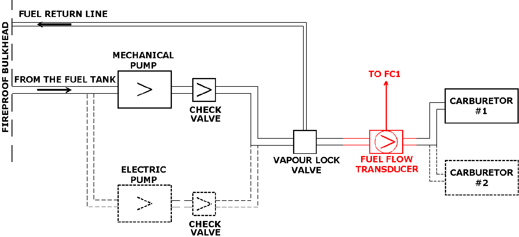

I will too install a fuel computer this winter to my 912s.
In the manual of my FC1 Flybox is a schematic I will post here
and I can“t see why it shoud not work.
Even measuring the fow of only one carb it should be no problem to find
the right k-faktor setting.
Juergen
