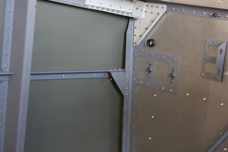

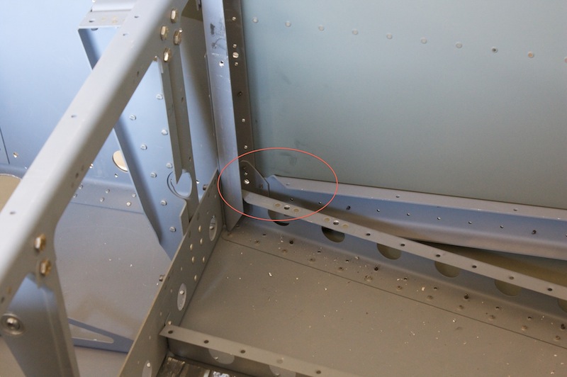

Working on wrapping up the dreaded Section 29 and have come across two
areas where I am unable to get the skin rivets bucked. The attached
pictures show the two areas. One is in the bottom right corner where
the F-1041 meets F-1042 and the other is behind the F-1001J where the
forward longeron attaches.
What have others done in these two spots? Anyone have a special bucking
bar recommendation or maybe the use of pop rivets in these areas?
-Sean #40303

PostPosted: Tue Oct 19, 2010 1:25 pm    Post subject: Tough Rivets on Fuse Forward Side Skin Reply with quote
My tungsten bar fit in those places without an issue. I know that wasn't
the answer you were looking for.
Bob

jeff(at)westcottpress.com
I used 1/2" and/or 3/4" steel bar material in areas like this....
resulting in very sore fingers for a few days afterwards.
Jeff Carpenter
40304

PostPosted: Tue Oct 19, 2010 1:40 pm    Post subject: Tough Rivets on Fuse Forward Side Skin Reply with quote
Is that the modified emp bar you are referring to? Unfortunately an
RV-10 builder in Prescott, AZ "borrowed" my emp bar a few years ago and
never returned it. Cannot remember his name or if he is even still around.
-Sean #40303

PostPosted: Tue Oct 19, 2010 2:25 pm    Post subject: Tough Rivets on Fuse Forward Side Skin Reply with quote
Nope, my tungsten bar is relatively thin, but unmodified. I also have some
thinner steel bars, but don't recall using them there.

rv10builder(at)verizon.ne
PostPosted: Tue Oct 19, 2010 2:34 pm    Post subject: Tough Rivets on Fuse Forward Side Skin Reply with quote
Bob;
You just had to rub that in!!, but actually it's the perfect answer. The bar
is small and tough, but it's expensive too. It does work very well for a
person just starting who could benefit from it throughout the build.
Sean;
I used thin plates (1/2 in or so) initially and grinded down one of my
bucking bars to fit after not being able to take the abuse of the riveting
on the plates.
You'll have many more small areas that will need tight riveting. Consider
cherry rivets or pop rivets- which BTW I rarely did until the RV-12 came out
and I figured the whole plane is pop rivets so it can't be that bad.
Pascal

sean(at)stephensville.com
PostPosted: Tue Oct 19, 2010 2:45 pm    Post subject: Tough Rivets on Fuse Forward Side Skin Reply with quote
Did you purchase the bar or make it? If you bought it, do you have a
reference link?
-Sean #40303

PostPosted: Tue Oct 19, 2010 2:54 pm    Post subject: Tough Rivets on Fuse Forward Side Skin Reply with quote
Here's a less expensive tungsten
choice....http://www.tungsten-bucking-bar.com/prices.html

effectus(at)rogers.com
PostPosted: Tue Oct 19, 2010 2:57 pm    Post subject: Tough Rivets on Fuse Forward Side Skin Reply with quote
You can get them from Mike Lauritsen at Cleaveland Tools
PostPosted: Tue Oct 19, 2010 3:00 pm    Post subject: Tough Rivets on Fuse Forward Side Skin Reply with quote
Stein sells a tungsten bar. Make sure you're sitting down when you

rv10(at)colohan.com
PostPosted: Tue Oct 19, 2010 4:55 pm    Post subject: Tough Rivets on Fuse Forward Side Skin Reply with quote
I picked up a tungsten bar from ebay, sold by the fine folks at www.tungsten.com.
Works great.  It is edging out my Cleaveland Main Squeeze as my "favourite tool".

PostPosted: Tue Oct 19, 2010 5:00 pm    Post subject: Tough Rivets on Fuse Forward Side Skin Reply with quote
Sean:
Here's what I did for that situation:
http://deemsrv10.com/album/Sec%2029%20Fuse%20Side%20Skins/slides/DSC02624.html
I used a cutoff wheel on a die grinder to make the cut,
BTW ,I think I know where your emp bar is, it found its way into my hangar, send me your address and I'll send it to you.
Deems
