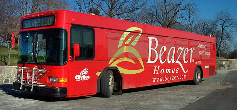

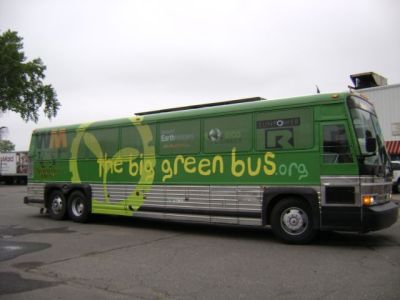

  Even 5 years ago the proper vinyl material was pretty bullet proof. If you see vinyl covered tour busses, taxi cabs etc… they hold up pretty well. A company we have partial ownership in sent a Rock & Roll mobile stage & tour bus out on the Warp Tour for 7+ years in a row crossing the country setting up at various venues where stoned & drunken teens hung out around, barfed on and in general abused the vehicle and the fully vinyl covered vehicle looked pretty darn good after all that. That truck never saw a garage or covered storage.. Also keep in mind that most planes look much worse for wear after sitting outside for 5 years too. Heck if someone wanted my recommendation for a plane purchase and said it had to live outside I would not recommend a Vans aircraft. Another difference is you can peel off the vinyl whenever you want and replace for a heck of a lot less than a new paint job.
  One last word on vinyl. Since the original request was about stripes I wanted to mention that not all stripes are the same. If someone were to adhere thin vinyl stripes on a plane the chances of pealing or sagging is a heck of a lot greater than placing a wide meaty stripe on that has significantly more adhesive surface area. Something like a Stars & Bars sticker is not going anywhere once it has cured on the metallic surface. If someone were to place a large #8 on their tail it would probably stay in place and give the owner no issues for a long time but if the owner had an #8 printed on a large round circle say like a Billiard 8 Ball graphic that baby is not going to be an issue for a decade.

PostPosted: Mon Oct 25, 2010 6:24 am    Post subject: Vinyl stripes? Reply with quote
I am sure not all vinyl is created equal (not even close). I would start by asking some of the large companies that print and adhere vinyl on trucks and tour busses. We hired a company out of Canada to do the tour bus and mobile stage. That was 7 or 8 years ago. As a suggestion look for a supplier that offers the perforated vinyl. Perforated vinyl is typically used for window applications. I would suspect any company that makes the perforated vinyl is probably a serious vendor in the marketplace. From there I would review their solid vinyl offerings.
Robin
