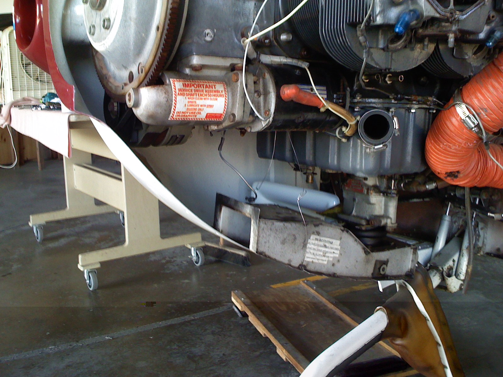

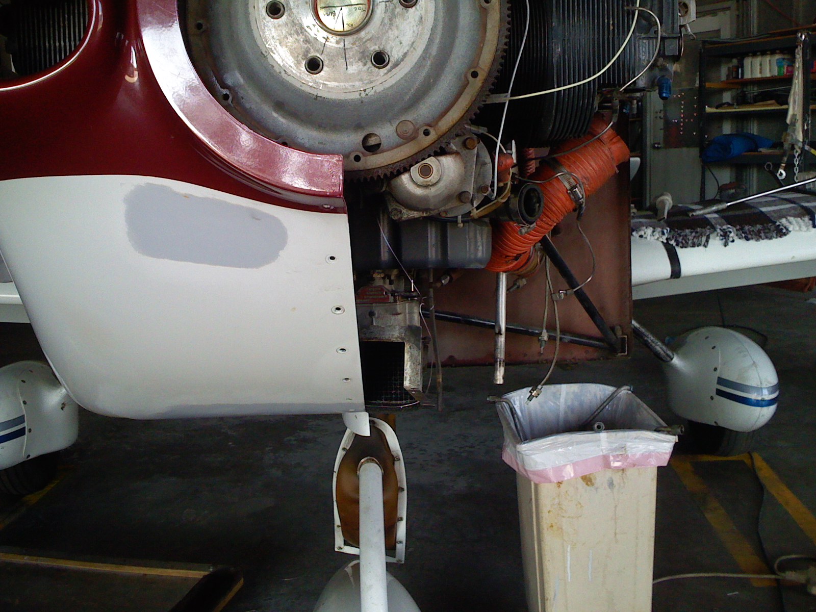

Yes. see pics. Here is half a cowling fitted to a Cheetah.

Gary,
So you use the same hinge the factory upper cowling uses with camlocks to hold the halves down instead of the crappy latches and the nosebowl and lower is one piece that is split vertically for easy access to alternator?
Brock

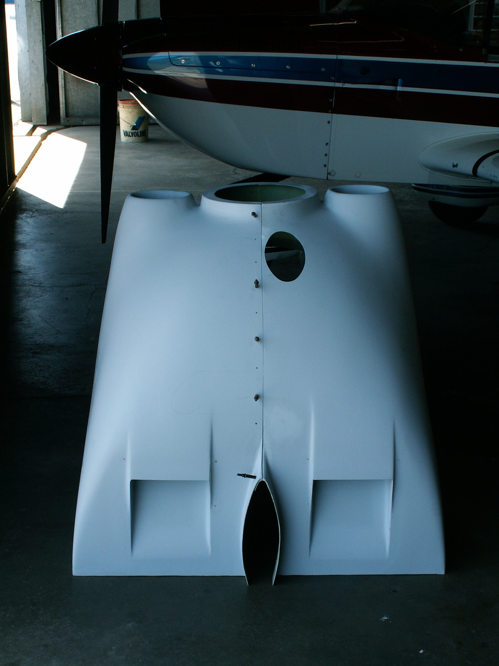

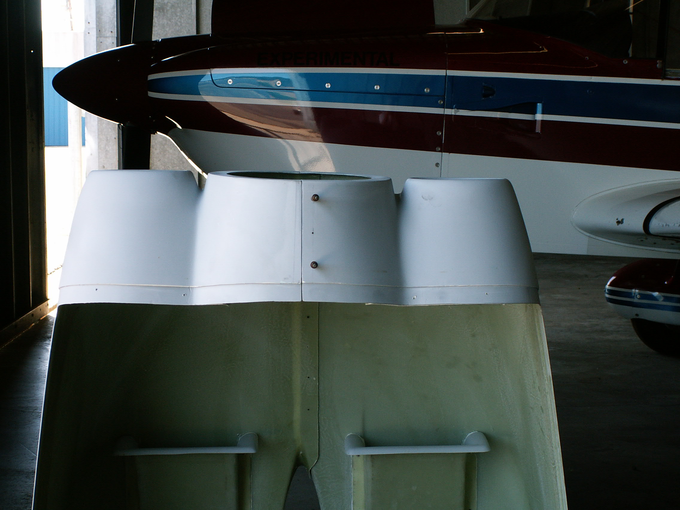

Phil,
your email went to the spam folder. here are the answers to your questions.
1.  Can you post some pictures on your web site or send me pics with enough detail to show where cam locks are installed, what the aft cooling ramps look like from inside and outside the cowl,
What the nose strut accommodation looks like, and some pics of the baffle installation.
----- pic shows the cowling on my plane and a fresh cowling in the foreground.
2.  Could the top cowling be installed without the hinge and adding an oil door using a field approval? What’s your best guess.
----- probably. but you don't gain anything. It takes just a sec to open the cowling and servicing is pretty easy. the centerline hinge adds some rigidity to the cowling.
3.  Is the aft portion of the top cowling attached using cam locks or does it float like the oem one?
----- it's like the original.
4.   Is the whole cowling held together with cam locks or just the top cowl to the bottom?
----- just the upper doors use cam-locks.
5.   Can I use the existing rubber nose strut boot? Or what is the method used to accommodate the nose strut?
----- probably. my original design used the boot. I hated it. Makes R&R of the cowling too much work. see pic. since this was taken, the landing light opening has been moved down and outboard to the left.
6. I assume there is no measureable speed increase, correct?
----- I did the STC with-respect-to improved cooling. I didn't want top open up the performance change can-of-worms.  Realistically, at the same rpm, expect about 5 knots. on the original plane, 119ST, I saw anywhere between 6 and 10 knots increase. side-by-side with a stock plane, you'll see less fuel burn at the same rpm speeds and settings.
7. Do you have any data on the Delta T in ⁰F between cylinders 1 & 3 and 2 & 5 (sic) with the new cowl?
----- I think you mean 1 & 3 and 2 & 4.  On my plane, ported and polished cylinders, at 2700 rpm, I can get the CHT delta down to 20 degrees. EGTs down to 10 degrees delta. #1 runs hot on climb-out.
Any more questions, feel free to ask.
