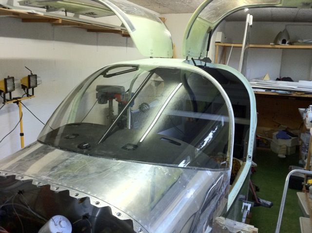

Hello,
after having read so much about the Weld-On 10 stories and the crazing etc I took the step last weekend and installed the windshield with the help of two friends. I guess the result is very satisfying no crazing.
I put a write up and photos on my website which describes what I did.
I just wanted to share my experience.
It was quite easy to do. And I hope that crazing will now develop in the future.
Write up:
http://www.wellenzohn.net/HB-YNN/Construction_Blog/Eintrage/2010/10/19_Glueing_the_windshield.html
Cheers
Michael

Congratulations on the good installation and the fine "write-up". I think that you have established the protocol for window installation. If others can replicate your success it would be awesome. I had crazing at two locations with the suggested Vans technique. Fortunately they have not "run" in the one year that the plane has been flying. Thanks for sharing your experience in the finest Matronics tradition.

I think that window installation with Weldon without crazing is the norm and has been done for several years. Good write up.
