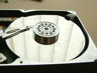

Hmmmm . . . I can see that a drive might be liquid tight
for low pressure heads but they're not well 'sealed'
[img]cid:.0[/img]
Looking at the spacing between cover screws that hold
a thin sheet metal cover down against a gasket does not
suggest any ability to keep the drive interior from
exhausting at altitude. I've had one experience with
a data gathering task where I put my laptop in
the tail of a Beechjet. The intent was to stay below
10K feet. I had other equipment in the passenger
cabin too. During the flight, it was determined
that we needed to go up in altitude. Putting a
new hard drive in my laptop was a whole lot cheaper
than the cost of fuel and $time$ to land and
recover the un-protected computer.
After the flight, the hard drive was trashed
and could not be recovered. I seem to recall
foam-plugged vent holes in hard drives that
I've taken apart . . . but examination of
the WD and Maxtors laying around right now
failed to find one without tearing it apart.
This teardown article speaks to an on-purpose
hard drive vent.
http://www.pcdoctor-guide.com/wordpress/?p=595
 Filesize:  63.51 KB
 Viewed:  13395 Time(s)
Tim Olson
Joined: 25 Jan 2007
Posts: 2882
PostPosted: Tue Oct 19, 2010 11:17 am    Post subject: Laptop supply for your car/airplane Reply with quote
Definitely not true. They aren't sealed 100%, they have vents,
and over 10K' definitely does kill them. I had a couple
that wouldn't operate at 13K' one day. Switched to
SSD's because that's what you need over 10K. Yes,
sometimes it'll be fine, but sometimes it won't. And it
CAN damage the drive because the heads need to float on a
cushion of air, and even if it works, the cushion will
be less at altitude.
Air permeates the vents, even if water stays out
reasonably well.
Tim
