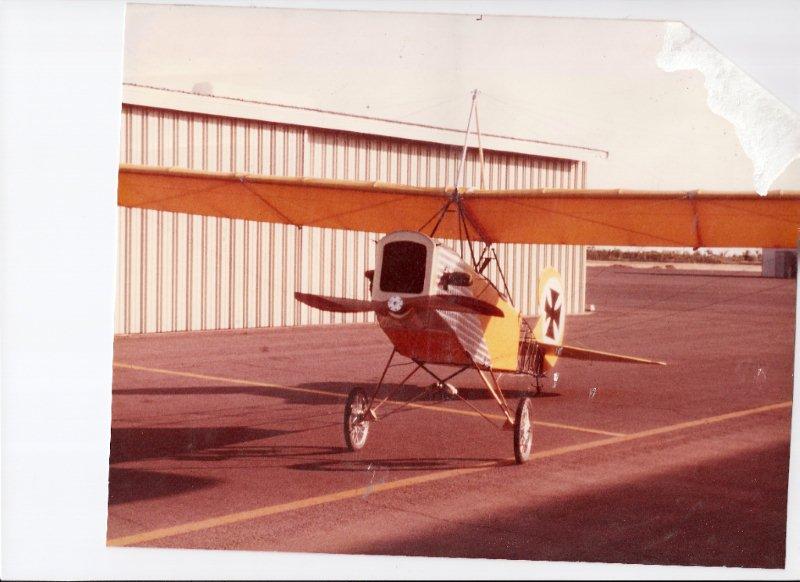

hi all I built a plane in the mid 80's and used 20 in bicycle wheels. had them custom spoked to a mini bike hub with breaks and larger spokes. flew the heck out of this plane. it was a wing warp design and I had lots of x wind landings

Craig, Nice looking aircraft !

After I sold this plane the new owner ground looped it at high speed, bent a wing tip  and scrubbed the gear clean off the plane….. after all that the wheels straight and true
