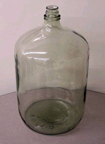

Didn't they start out as water cooler bottles?  Now the watercooler bottles are plastic.  I do have a glass one that I used to make beer in but havn't done it in quite a while.  Good thing we can get non oxiginated premium gas up here in Mn.  That's what I run through my Jabiru and Rotax.  Take care,  Jim Chuk

It is a large small mouth bottle used in making beer.
[img]cid:part1.06060001.03090808(at)austin.rr.com[/img]

Pete,
Pardon my ignorance in this matter, but please describe what you refer to as "a 6.5 gallon carboy"?
