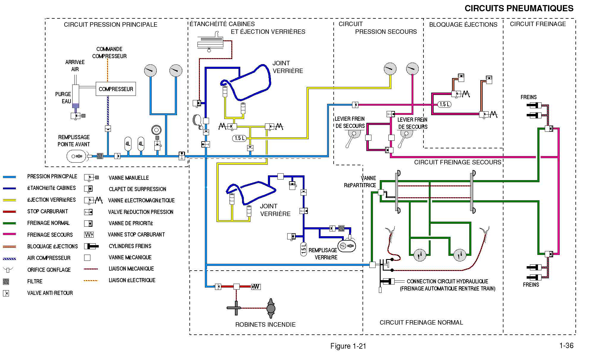

The compressor is in place on my plane in 1998. Its always works well.
It il in place in the front, right side, where was the originally IFF.
It is an electric compressor with a switch on the mail panel, front place. I put it off when aerobatics.
You have to check the oil once a year.
It is on bigs silent-blocs.
It gives air pressure for everything, except the rear canopy seal.
Begins to work at 20 psi, stops at 50.
Takes 14 minutes from 0 to 50 psi, and 7 from 30 to 50.
There is a water draining to be open after each flight.
I have no leaks on my air circuit.
Best regards.

PostPosted: Thu Oct 14, 2010 4:33 pm    Post subject: L-29 Compressor Reply with quote
Wow, that's pretty cool. One question though. Do you mean PSI or BAR (ATM). Minimum onboard air pressure is 50 BAR which is about 725 PSI. Max is 150 BAR or 2175 PSI. If your electric air compressor goes to 725 PSI in 15 minutes and you have had no moisture related failures of your air system,  I'd like to buy one. Do you have a make and model for it? Thanks!
BTW, make/model for ultrasonic leak detector is Amprobe UT-300...
- The Matronics L29-List Email Forum -
http://www.matronics.com/Navigator?L29-List
delfin(at)mail.pf
PostPosted: Thu Oct 14, 2010 5:15 pm    Post subject: L-29 Compressor Reply with quote
Sorry, it is not psi but Bar.I have no idea of make and model. I think it is a czech one.
Jean
