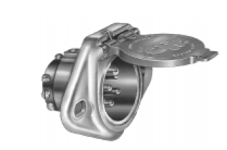

You can build your own ground power cable from say 6AWG
wire and use a trailer connector to mate it to the airplane.
[img]cid:.0[/img]
Mount the connector close to the battery to minimize
length of always hot wire. Connect three pins to battery
contactor input using 12AWG wire. Three other pins to
battery(-) ground. If it makes you feel better, put
a mini-ANL 60 in series with the (+) wire right
at the battery contactor.

This setup is probably much more appropriate for my purposes, but I thought the aircraft-practices gods would smite me for suggesting such heresy. And then there was the gospel of St. Nuckolls, preaching Ground Power Jacks in Z-31(2?). So I nuckolled under and installed the Piper version and am now capable of sucking the lights out of a nuclear power plant without breaking a sweat.
And I'm glad of it.
I like knowing that I can cart-start my engine without pulling the top cowling and having a line boy dragging heavy cables over my paint job and then having to disconnect them near a spinning prop, even though I don't expect to have to do it often. And I bet system installed weight differs by about a pound. A small price to pay for start capability. As you pointed out at one time, the mission of most of our airplanes is to have fun boring holes in the sky and occasionally going somewhere. An extra pound or two of convenience doesn't materially affect accomplishing that misson and can greatly enhance it in certain circumstances. Like when my battery is drained by my stupidity and an FBO or mechanic can plug in a standard connector and get me on my way. And when that happens I can already feel the satisfaction of having installed the start-capable GPJ.
