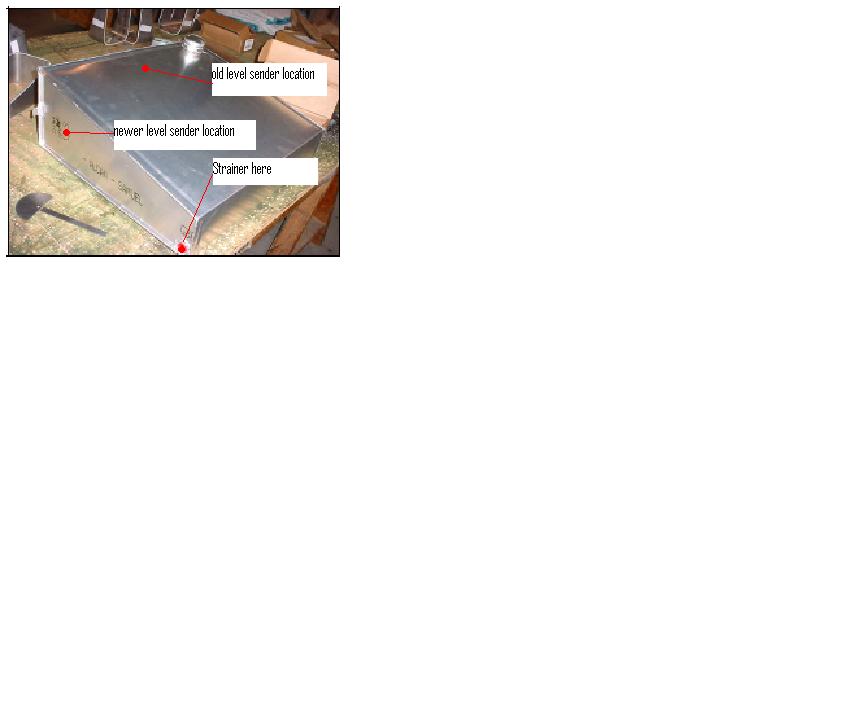

I purchased my bird so do not have the benefit of seeing this part installed. i am wondering what the 701 wing tank fuel pickup looks like. and where it is normally. the drain is inboard at the rear. the fill neck is outboard and forward. the elec fuel gage tube runs about 4" back of front wall from the inboard face..
Is it just a hole/fitting in the side or a upright tube on top of the drain with holes so one piece of debris can't plug it instantly.
I had parts of the fill spout from the gas can i was using come off the other day. ( into the tank) it was the special spring loaded auto shutoff type. after much fishing i got it + spring attached out. but on the last flight this tank was not gravity feeding as before. with the tanks full as this one was i never had to worry about fuel flow. after the first time switching to this tank in flight the engine started to stumble. a quik check of the glass on the cabin fuel filter showed it empty. i flipped on the elec. pump and it filled up and ran smooth. several cycles like this showed some improvement. but not back to the gravity feed level of the other side.
could i have damaged anything in the tank fishing around with a heavy wire? there was about 6 L left in the tank while i was looking about. the borescope i was using didn't have enough strength or clarity to see the inboard side or back inboard corners. so i can't get a look at the pickup from here.
this was not as scary as it sound as i had lots of fuel in the other tank and was flight testing for this very problem before in was one.

PostPosted: Wed Oct 13, 2010 12:25 am    Post subject: fuel pickups ? Reply with quote
Ross, the plans show a finger strainer fitting at the fuel outlet
which is at the back on the inboard side of the tank just above the
drain.
Roy

PostPosted: Wed Oct 13, 2010 2:24 am    Post subject: Re: fuel pickups ? Reply with quote
See attached photo of right side tank, as viewed from cabin.
Kevin

PostPosted: Wed Oct 13, 2010 3:57 am    Post subject: Re: fuel pickups ? Reply with quote
thanks guys. this is just what i was looking for and suspected. I am thinking the screen may have been crunched some. next question. can it be serviced by removing the wing fairings.. removing the tank would require major surgery on the wing Sad I am getting more crud in the cabin fuel filter from muckin about inside this tank. from stirring up sediments or compromising this screen.

PostPosted: Wed Oct 13, 2010 4:47 am    Post subject: fuel pickups ? Reply with quote
Ross, the fuel pickup in the tank is essentially a pipe thread bung welded to the sidewall of the tank near the bottom back corner. Standard proceedure is to thread a finger screen into this bung and then the barb fitting threads into the finger screen. If there is a finger screen in place (two inch long cylinder of metal screen) then the incident you are decribing should not have affected your fuel flow.
I don't remember if the 701 plans show the installation of a finger screen or not but I know the 750 does since I'm helping to build one of those now. If your plane doesn't have finger screens it would be a good idea to install them.

PostPosted: Wed Oct 13, 2010 5:36 am    Post subject: fuel pickups ? Reply with quote
You'll have to get at the fuel pickup opening in the tank to get at it to
put on a new fuel strainer screen. Yes, the 701 plans call for one. Even
if it is a bit bent up I can't see this stopping most of the flow from the
tank. Possible, I suppose. Are you sure that you got all the debris out
of the tank?
It might be possible to borrow or rent one of those flexible borescopes that
most A & P have access to to have a good look at the tank from the inside.
Basically it's a a physician's flexible sigmoidoscope . I've seen the
short ones (sigmoidoscope) and long ones (colonoscope) in the larger
aircraft repair shops and have been intrigued by them, as they are EXACTLY
the same as what I use (used) on humans before I retired. You could get a
great eyeball close up with one of those if you can borrow or steal one for
about 3 1/2 minutes!
When I built my plane I screwed up and didn't put an inspection plate to
access the pickup tube (or fuel sending gauges) in my tanks, so if there
isn't one on your plane, the only way to access the tube would be to cut an
inspection hole either on the underside or above it on the top. But I'd
sure look at it from the inside with a scope if possible before doing major
surgery like that..

PostPosted: Thu Oct 14, 2010 8:42 am    Post subject: fuel pickups ? Reply with quote
Ross
As you did not build the plane possibly your tank was
sloshed with some type of sealant which you have broken up causing it to
block strainer screen.
Normally looking in filler you will see clean aluminium walls & bottom of
tank
If it has been sealed you will probably need a new tank as I doubt you
will be able to clean it. possibly someone on list can advise.
Clive

PostPosted: Thu Oct 14, 2010 6:55 pm    Post subject: Re: fuel pickups ? Reply with quote
OK . i borrowed an end on flexible scope. tank is clean and shiny inside. screen is good shape. removed gas-line to inner cabin filter blew out = no dirt, checked flow measured gal/min from both tanks and are equal both sides. fill cap was off at this point
