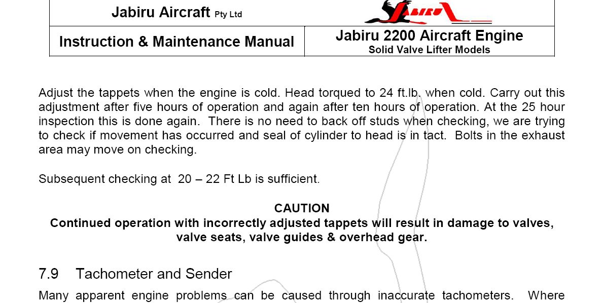

I found the torke value in this document :
http://www.jabirupacific.com/pdf/HeadTorqueValveSetting.pdf
MicheL

reading
Adjust the tappets when the engine is
cold. Head torqued to 24 ft lb. when cold. Carry out this adjustment after five hours of
operation and again after ten hours of operation. At the 25 hour inspection this is done
again.
I supposed 24ftlb was the torque for the nut (as it is int the "tapped adjustment" paragraph
MicheL (not very good in english)

So from the manual below, if you can see the 'zapgrab' picture generally it's 20-22ft lbs
This is from section 7. This is manual has been updated from the one I got with my engine, I only have that on paper and I recall that being 18 ft lbs, the front cover of this manual I just downloaded from the Jab Aus site says it's applicable to all 2200a engines. The 'soft headed' ones all surely bend at 22 lbs...
What vintage is your engine? And the heads?
Regards, Clive

One remark on this. The text mentions not to back off the studs. After working with Roger on my engine and discussing I am convinced that's bad advice.
The bolts go all the way through the head and screw into the cylinder. On my engine, the exposed threads had corrosion on them. This corrosion caused the bolts not to move at 24lbs even though the heads were starting to leak. Do check for corrosion, use WD40 or similar to lubricate the corroded end and back off the stud a little bit. Then retighten at 24lbs/ft (or whatever your vintage manual tells you).
Rob
 Filesize:  118.23 KB
 Viewed:  25882 Time(s)

It's a 2200 serial #570
I'm not looking for the torque for the cylinder heads but for the valve clearance adjusting screw (and nut)
MicheL

For the same reason on older heads where they deform check by backing off and if necessary take the bolts out and clear the hole out with a drill bit.
My old heads on the 2200 twisted badly (#596) and I had trouble getting the head bolts out for this reason.
CJ
Rob
 Filesize:  118.23 KB
