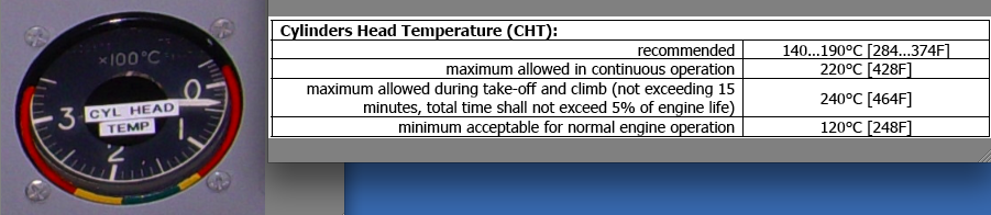

PostPosted: Sun Oct 10, 2010 4:31 pm    Post subject: Cowl design and CHT Reply with quote
Mark:
I had what I considered to be somewhat high CHT on a VERY LOW TIME first run factory engine. This was with factory settings which I was loathe to touch. I'm in Western NY state, so you'd think average settings would cover me. I have checked and tightened various things, including cylinder and supercharger case gland nuts. The temps seem to have crept down. Maybe some of it is break-in, although Jill G. would say break-in is done on a test stand before it sees an airplane. Maybe I've gotten better at managing climb angle, etc.
Rick Volker has been around this plane and felt there was an issue compared with the Sukhois he owned. He also feels spinner and cowl play a big part. as you've read.
I did ring up Vladamir Yastremski (sp?), and he said my temps were well within acceptable limits, and to worry more about low temps. Dennis S. has said about the same thing in the past. Rick suggested test where I climb-out at Vy to 5000 ft. I tried that, and I kept it under 210 C, and then leveled off at max cruise, after which time it stayed in the high green. So that wasn't bad. Now keep in mind this was at 63 degrees ambient at the departure airport (KBQR 752').
About all of these jets: Richard Goode says they all need adjusting, and I think it was Sergei Prolegiev who suggested that I get it out of my head that it left the factory perfectly adjusted. I do have a slight hesitation when I feed power back in on final, but it's not scary. I have all of the different jets, if only I knew what I was doing. I was hoping one or two clockwise clicks on the cruise mixture adjustment would enrichen the mixture enough to make my plane and I happy. I do have great fuel economy, so maybe I'm lean.
Here's my gage and the Yak-UK translated DOSAAF manual I usually go by. Remarks, anyone? -Eric
[img]cid:F0FADBD6-963C-42F6-A4AE-776FA40324EC(at)home[/img]
On Oct 10, 2010, at 7:32 PM, Bitterlich, Mark G CIV Det Cherry Point, MALS-14 64E wrote:
[quote]--> Yak-List message posted by: "Bitterlich, Mark G CIV Det Cherry Point, MALS-14 64E" <mark.bitterlich(at)navy.mil (mark.bitterlich(at)navy.mil)>
No, I am talking about the main mixture jet, which Richard Goode refers to as the "Compensation Jet". Although yes, I have messed with the one you are talking about.
Being perfectly clear here Eric, I was just a spectator. I profess no special knowledge on this darn thing other than:
1. I have seen where adjusting the accelerator pump jet will cure hesitation on throttle advancement versus just plugging the darn thing, which was the initial cure until smart people figured out you could buy a jet kit and adjust it accordingly. I am VERY familiar with this kind of thing because you run into it a lot adjusting a Holley carb where there are many MANY adjustments for the amount of fuel you dump in when you move the throttle plates.
2. The main jet or "Compensation Jet" has the ability to dramatically change fuel mixture in the mid to high range of engine RPM.
I would very much love to hear Richard Goode go into more detail on how he determines how much change to make based on engine indications. He obviously has way more experience than I do. I have seen it done ONCE... but it worked, in a big way.
I would also like to hear Richard tell me how many clicks on the back of the carb equates to one jet size....if that is the case at all.
Mark
From: owner-yak-list-server(at)matronics.com (owner-yak-list-server(at)matronics.com) on behalf of Eric Wobschall
Sent: Sun 10/10/2010 4:20 PM
Subject: Re: Cowl design and CHT
--> Yak-List message posted by: Eric Wobschall <eric(at)buffaloskyline.com (eric(at)buffaloskyline.com)>
Mark, when you say the fuel mixture increase made a big difference, do
you mean the click-stop adjustment on the back of the carburetor?
On Oct 10, 2010, at 3:05 PM, Bitterlich, Mark G CIV Det Cherry Point,
MALS-14 64E wrote:

 Filesize:  111.2 KB

[quote] I really do not feel qualified to advise you on any of this. If you are asking for my OPINION... well... ok.
The slight hesitation when adding power on final can probably be cured by changing the size of the Acceleration Pump jet. However, I would not do this if you plan on messing with other adjustments. I'd do it last. However, I WOULD mess with this one. It's easy and the change will be felt immediately when you go flying and you are not messing with fuel ratios. Just fuel delivered when the throttle is moved.
I trust Vladimir Yastremski and Dennis and realize fully that both of them have more knowledge and experience on this engine than I probably ever will have.
But if you want to go on .......
Before even thinking of adjusting your carb, make absolutely certain that your timing is correct.
Next... the nice thing about this and most other well build carbs is that you can always put things back to where they were if you are not satisfied with the change you make. The important thing is to be very careful to know where you started and how to get back there should you have to. Be very VERY careful to document everything. I am tempted to advise you to turn the adjustment screw out and count the clicks until it reaches the stop, so you know EXACTLY where it is now. However, having not have done this myself.. and having only read about it... . see what I mean?
It seems that no one on this list has any real first hand experience in making these adjustments. Me included. Several of us have watched people doing it that seem to understand the concepts. Second hand knowledge to be exact.
My YAK-50 will run right up to the red if held in a max performance climb to 5000 feet and I consider it to be adjusted perfectly. Push it over and climb at Vy, and it will stay at high end of green, just as yours seems to.
It's up to you.
Mark
