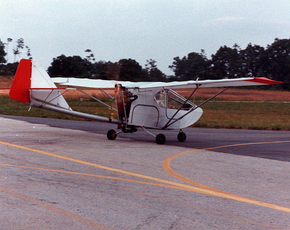

I tried putting fiberglass rods in my old Hawk legs (same idea - different material). Built one in 1983 when they first came out. The Alum legs still bent, the fiberglass rods bent too, and stayed bent. But they probably weighed about 10 pounds each.
1983 CGS Hawk, flaps and all.
 Filesize:  145.24 KB
 Viewed:  492 Time(s)
