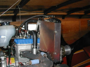

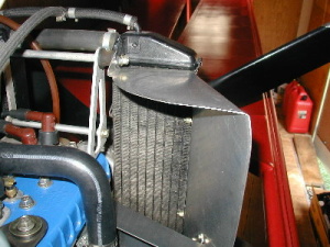

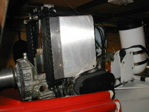

Back in 2003, Steven Green had a 582 on his MKIII, and was having trouble keeping the temps down with that radiator setup. Don't remember the details, but I did save the pictures he posted. The goal was to keep hot air from the exhaust manifold from going through the radiator, plus duct air around the carbs better, and he reported good results.
The pictures will have to be self explanatory, as I don't remember the details, sorry.
