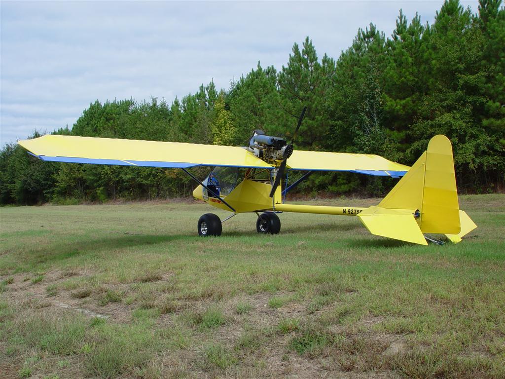

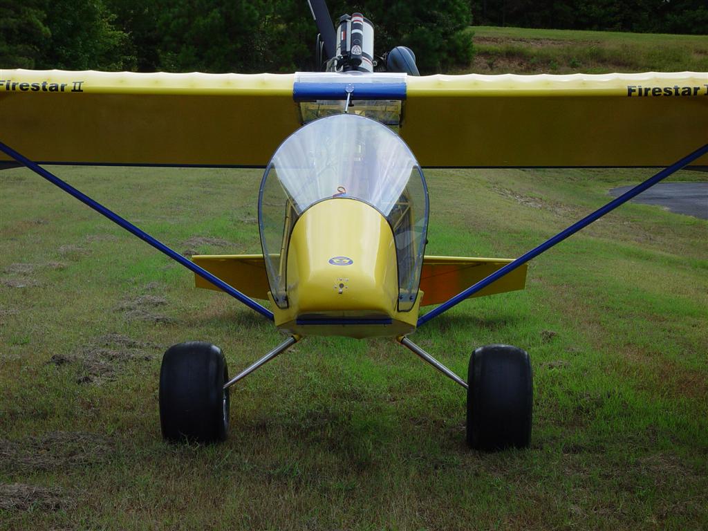

I am so glad I ran across this Forum..... There is a wealth of knowledge here, and some awesome pictures.... I have a Kolb Firestar II that I bought that I found on Barnstormers..... It had a few things that needed intention.... The Tail Wheel had broke off from a hard handing, and it damaged the elevator and rudder. Just the covering was damaged on the elevator, and the bottom of the rudder need the bottom tubing replaced. I have it almost finished, and just today I purchased a MicroAir 760 to install in a new dash I am working on... I did not like the drum brakes and I removed them and installed the Black Max 1000 system.... and to top it off I installed some wheel and tire combo that I have come up with...I have seen many people have the Carlisle golf cart tires on a 6" rim and call them Tundra Tires.... They are Heavy and Stiff, and the size is all I see that is close to being what is referred to as a Tundra Tire..... These Tires I have are Soft and only use between 5 and 10 pounds of air, and they are Light Weight........... They act like the Big Boys Tundra Tires in Alaska...... The Rims I have are 8" in Diameter, and fit on Black Max and Hegar wheel hubs, and maybe others..... Anyway I would like your input on what you think about my Tire and Wheel Combo........

Looks pretty spiffy with those big shoes! Welcome

Those big wheels are awesome!  I like them.

Thanks for the kind comments.... I didn't go with these Tundra Tires for the Looks, even though I think it Looks better with Large Tires.... I feel that the front gear on the Firestar bends to easy, and it should bend before making the cage bend.... These Tires just softens the suspension. The Kolb Factory quoted me $200.00 for New Main Gear, and hopefully these Tires will help me to not have to replace my Main Gear in the Future .......... Joe

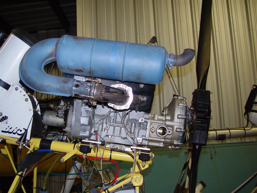

Good looking airplane. Moving the prop further away from the trailing edge will cut down on your prop noise. What is the reduction ratio of your gearbox?

The GearBox is 3.0 to 1 ratio with the RK400 clutch
I plan on putting a Stainless Exhaust system on it soon

Are those tires the Nanco 21x12x8?

Yes they are, do you use them as well...... Joe
