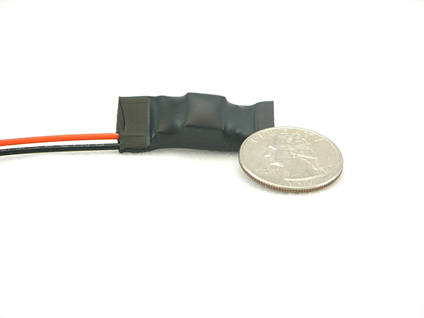

There is one built into my plane as it sits, using the module that I bought from B&C BC207-1 and AEC9034-1,
And there is one built into the new plane power alt. I have the module that will open the 5A breaker if there is an OV event with my current ND alt. The module is also used to test an OV event, and indicates low voltage.
Are you saying I should disconnect the OVM I got from B&C and just use the OV protection built into the Plane Power alt.
Both triggered by a 5A breaker. Is there any harm or potential harm in this?
No harm . . . but the rationale is mystifying.
I don't know if I should remove the OVM I got from B&C, or leave it in place. If I leave it in place, I would have two sensors.
The OVM from B&C and what ever Plane Power uses. I will attach a pic of the OVM. Hope it gets through.
Kevin
[img]cid:9D18C803-9ED9-4C08-A474-71021EE65435[/img]
That's the legacy crowbar ov protection module
produced first by AEC, then by B&C and now by
both companies. Yes, take that unit out along
with the associated b-lead contactor.
