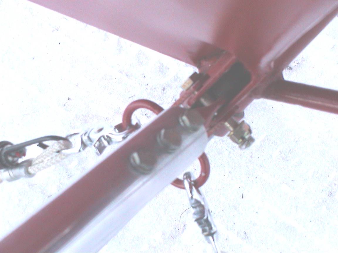

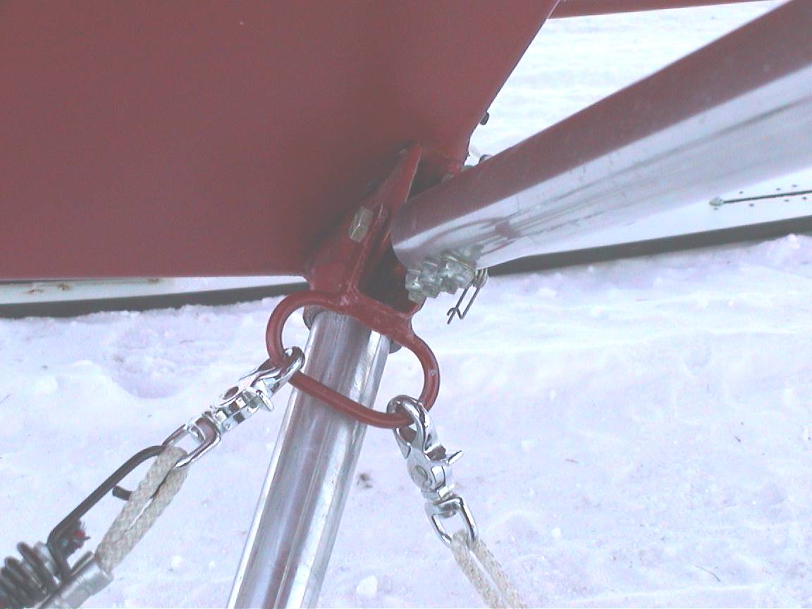

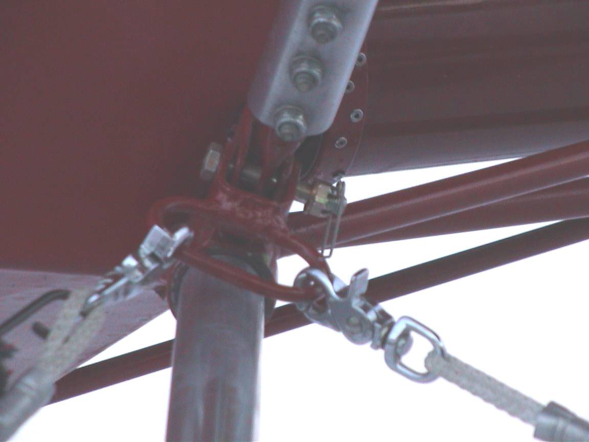

The attached pictures show a ski cable anchor design that has worked well for
me.  It attaches at the bottom of the lift strut and cannot move up or down like
gear leg clamps may.  It can be left on all year or taken off with the skis.
Hope the pictures explain it well enough for anyone who is interested.
Jon L

Jon,
Thanks ! Nice design ! Looks like it will work well !

Jon, this is by far the better solution for skis than the ski clamps I have on my Firestar. By the way Jon, do you remember who flew your Firestar on its maiden flight in March of '96? That was one to remember as the pilot ran into a little problem with the ASI, but he managed to fly it as if everything was fine.

john L
that is the best ski cable anchor design that i have seen on a kolb
