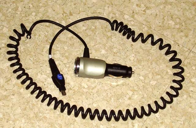

Just got home from the Post Office and had
an inspiration. I've been using the I-Go
universal automotive power adapters for
some years. The product consists of a switch-
mode power supply mounted in a cigar lighter
module . . .
[img]cid:.0[/img]

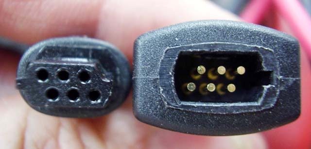

The appliance-end of the device mounts a "power tip"
that not only mates with your appliance of choice, it communicates
with the power supply on the other end to customize
its output to be consistent with the appliance. When you
pull the adapter off we see . . .
[img]cid:.1[/img]
Given the highly customized nature of this connector pair
and the huge production volumes, I doubt that they put
'extra' pins in the connector just for grins. but I could
be wrong. I'm reluctant to cut my adapter up but you can
get one from your local Radio Shack
http://tinyurl.com/29984nq
No doubt other electronics outlets sell them too. When you
cut the connector off, leave a long enough pig-tail so that
should you discover that the coil cord contains fewer than
your needed 5 wires (or my best-guess of 6 wires) you'll
at least be able to splice it back together and press it
into service elsewhere.
Another possible source is the "wall wart" box found
at many thrift stores. I've often found wall-warts having
ratings suitable to some task . . . then generally cost
$1.00 or less. I've seen automotive power cords in these
boxes too. One just MIGHT turn up an IGo cord.
Option 3. Just checked Ebay and purchased a power cord
for $4 including shipping. As soon as it gets here, I'll
dissect the thing and report findings to the group.
