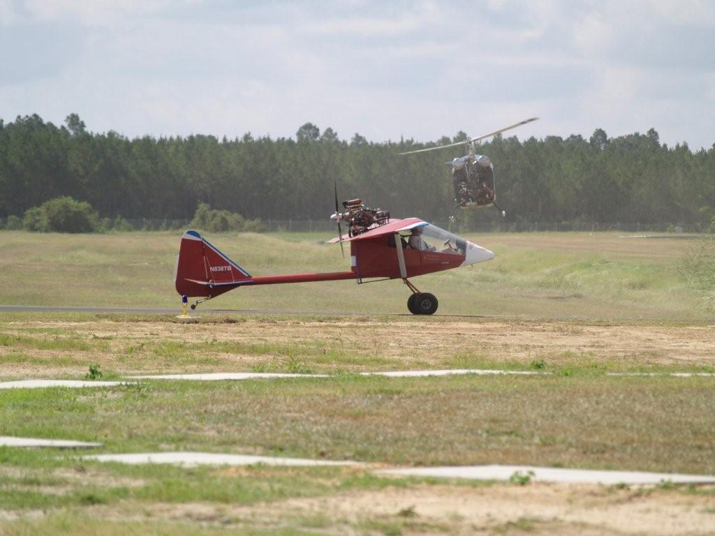

PostPosted: Mon Oct 04, 2010 4:26 am    Post subject: Kolb-List Digest: 7 Msgs - 10/03/10 Reply with quote
I decided to send a pic of my little slingshot idling, waiting to take off.
Note the angle of the blade in relation to the boom. Ted Cowan

PostPosted: Tue Oct 05, 2010 3:38 am    Post subject: Re: Kolb-List Digest: 7 Msgs - 10/03/10 Reply with quote
Ted,
My slingshot hits a wall at 95 mph and that is its top speed. Anything above about 85 mph requires more and more nose down elevator. I believe that this is due to the thrust line angle being way too high, as you mentioned. I suspected this but could not get Travis to tell me what angle it was supposed to be so I've left it alone. The drawings and plans that I have don't say. That is probably why Travis could not tell me.
Now that I know your aft end of the mount is 7/8" higher than the forward end, I can start thinking seriously about fixing mine. Since the motor mount for the Jabiru is way different from the Rotax, 7/8" may not be the right answer for me.
At your convenience, if you could measure the thrust line angle relative to the bottom chord of the wing and let me know what that is, I can adjust the Jabiru motor mount for that angle. Right now, my thrust line is pointing UP by 3.5 degrees relative to the bottom chord of the wing and it should be pointing down somewhat relative to the bottom chord, based on your photo and what you said.
Thanks for your help.
Thom Riddle
Buffalo, NY (9G0)
