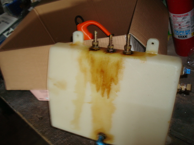

I thought I had a good sealer for the header tank plastic to fittings, BUT as you can see from the attached photo. The tank has only been in use 3 months. Any idea on the best stuff to use
George
Kitfox Sport almost, but not yet!
 Filesize:  91.21 KB
 Viewed:  35109 Time(s)

PostPosted: Mon Sep 27, 2010 1:35 pm    Post subject: Sealant for header tank fittings Reply with quote
Proseal? Larry

PostPosted: Mon Sep 27, 2010 1:37 pm    Post subject: Sealant for header tank fittings Reply with quote
Yikes! John Mcbean can point you in the right direction. Used the sealant that came with my kit (2004 vintage) with success. Better check those fuel tank fittings also.

PostPosted: Mon Sep 27, 2010 1:56 pm    Post subject: Sealant for header tank fittings Reply with quote
George, The absolute best sealer for that application is Dow 730 Aircraft Spruce p/n: 09-00383. I finally broke down and bought a tube and haven't had a leak since. The only draw back is cost. It's over a $100 for a 3 oz tube with shipping. I keep it in the
refrigerator and hope it lasts. Someone on this list recommended it. I tried everything else 1st.

PostPosted: Tue Sep 28, 2010 1:54 pm    Post subject: Sealant for header tank fittings Reply with quote
Thanks for the great info!

PostPosted: Tue Sep 28, 2010 8:33 pm    Post subject: Re: Sealant for header tank fittings Reply with quote
A very good product that some of the race car driver's use, auto mechanics, aviation mechanics and SLSA Mfg's is "Hylomar" Universal Blue gasket and joint sealing compound.
Use a film on the bulkhead plates,t gaskets or fittings all the way around and both sides. This stuff is very sticky so what ever you touch it is there until you use a little lacquer thinner to remove it. Let it flash or dry for a few minutes and assemble. Do not apply a glob as it will squish out and get into the fuel system and it will cause you headaches. A little is good, a lot is not better. You can buy this Hylomar on line from several sources as it is very common. I tube should be plenty.
I use this on all my leaks as recommended by a few Mfg's and have never had a repeat leak.

PostPosted: Wed Sep 29, 2010 7:44 am    Post subject: Sealant for header tank fittings Reply with quote
George,
After trying a half dozen sealants with the accompanying aggravation I finally broke down and bought the Pro-seal from ACS. It's the only one that I could get to work with 100LL.

PostPosted: Wed Sep 29, 2010 8:17 am    Post subject: Re: Sealant for header tank fittings Reply with quote
I used the Dow 730 sealant years ago after it was recommended to me by an aircraft-builder friend who worked for Dow. I managed to get Aircraft Spruce to stock it. Though it's expensive, I have not had a fuel leak on anything I've used it on, including tank cover plates and square-port fuel gauges. I saw another friend put it on a tank fitting and then pour fuel into the tank immediately, no leak. It's always worked well. I've had my tube for 20 years - it's still in the frig and still just as good as new. I look at the price like a complete "gasket kit" for a lifetime of fuel systems. Sky Geek has it today for $78.

PostPosted: Thu Sep 30, 2010 1:27 am    Post subject: Re: Sealant for header tank fittings Reply with quote
I use daily plumbers putty goo in a can from home depot.
$4 or 5$ a can -- good for gas,diesel and oils read the can.
Never had a leak but it has solved many in 35 year and Hundreds of planes.
DO NOT use Teflon tape!!

PostPosted: Thu Sep 30, 2010 6:40 pm    Post subject: Sealant for header tank fittings Reply with quote
Mike, Thanks for that recommendation a few months ago. Dow 730 was the only sealant that didn't leak on my plastic header tank. I have mine in the refrigerator on your advice. Wish I'd known about Sky Geek. A/C was $20 more.

PostPosted: Tue Oct 05, 2010 12:54 pm    Post subject: Re: Sealant for header tank fittings Reply with quote
If it's all the same to you guys, I think I'll keep using my Dow 730. Seventeen years and not a hint of a leak.

PostPosted: Tue Oct 05, 2010 1:11 pm    Post subject: Sealant for header tank fittings Reply with quote
I'm with Mike on this one. Just ordered the Dow 730. A fuel leak is
unacceptable.
