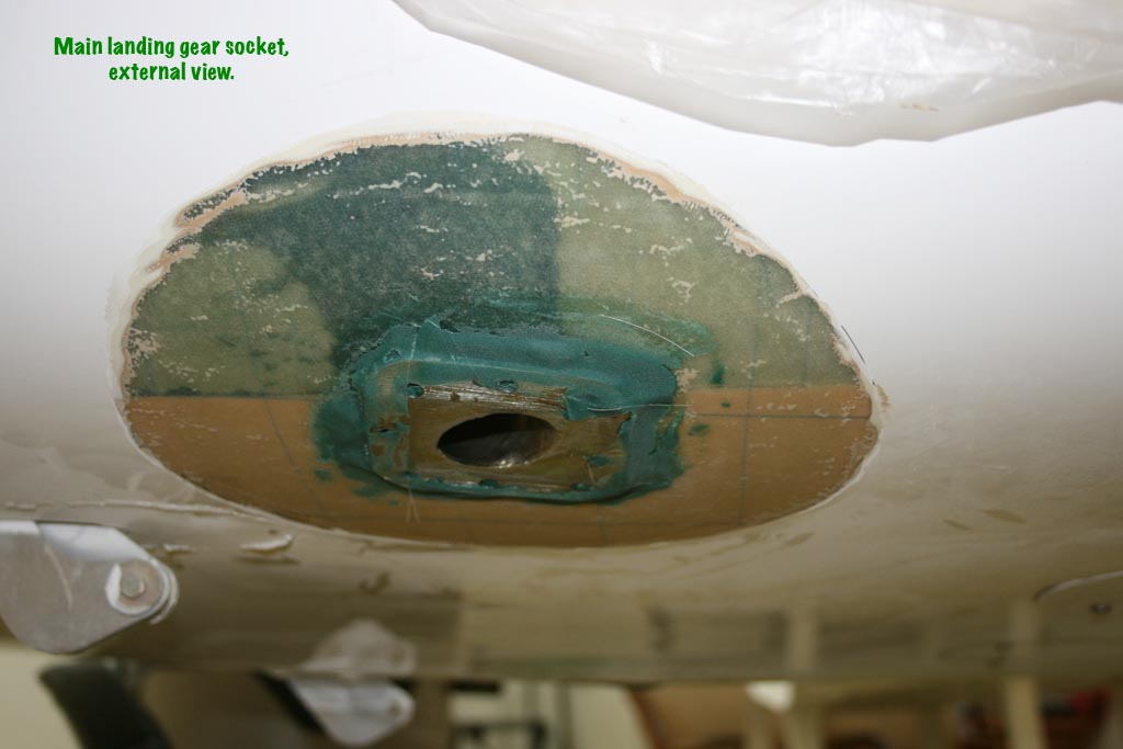

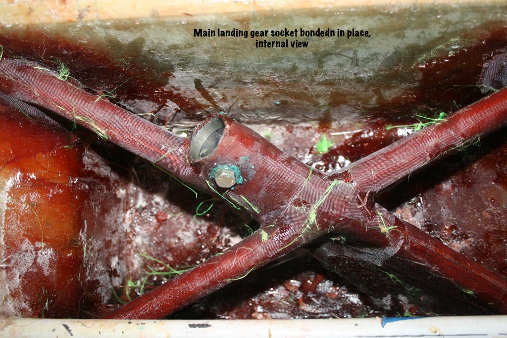

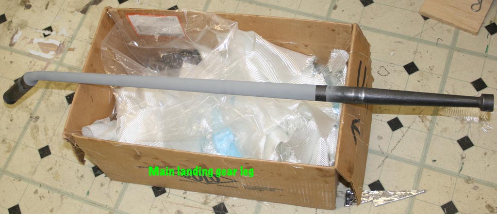

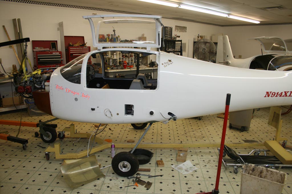

I have several hundred pictures of the process that I will have to high-grade for posting on my web site.
I have selected a few of the final pictures here:
[img]cid:2F2F2E10-765C-4B0C-B56A-9D67BE46AA5B[/img]
[img]cid:971BA761-4A3E-4873-A03F-2B33C6A4C73C[/img]
[img]cid:C3AEDD50-3226-4024-AF6B-CB044CC7DD89[/img]
[img]cid:3A386F79-8D4A-4386-8633-6E65D950602B[/img]
I don't have any pictures of the nose gear installation. I did go with the big metal springs rather than the bungee cord for the nose wheel. Nor do I have installation pictures of the flap drive mechanism or new brake master cylinder. I'll have to take some pictures of these when I go back out to the hanger to complete all the work and get the aircraft flying again.
For what it's worth, the reason for the conversion was a ground loop on takeoff. Broke the outrigger mounts on both sides and had a prop strike. The monowheel is just too sensitive on hard surface runways. It's wonderful on turf. A dream to land and take off. But on concrete it's a witch. I had been flying early in the morning two days in a row before the incident. Light winds, (runway 17, winds 0-7 kts variable 170 - 210 degrees) great for practice. No problems at all. On this day, the winds were still 0-7 kts from 170 - 210 and forecast to remain that way till after 1500 hrs local. The pattern was full of training planes. I made one takeoff and landing, no problem. All landings in the monowheel have been full stop, no touch and goes, so I had taxied back to the north end of the runway and waited for a break in the training traffic so I could take off. When the break came, I taxied out onto the runway and checked the wind sock, still light and about 210 degrees. I advanced the throttle slowly and the aircraft accelerated well, at 40 indicated I raised the tail and the aircraft started sliding across the runway sideways while turning to the right. I corrected the heading with some left rudder but before the aircraft was ready to actually fly, the left outrigger got into the grass and mud and turned me into a ground loop. Pretty bad at 40 kts. Damage to both outrigger mounts and a prop strike. Seems that after I taxied out and applied throttle the winds shifted to 16 G 20 from 270 degrees. The monowheel couldn't handle those winds. Literally blew the aircraft off the runway into the long grass and mud. What a mess. Having had a number of these excursion into the grass over the last year, mostly on landing, mostly due to excessive cross winds. I decided that I had an aircraft that was of EXTREMELY limited utility. Only safe to fly on nearly dead calm mornings and nothing else. Sure couldn't plan cross country flying since you never know what winds you'll find at the destination. And in the U.S.A. public turf runways are very rare. You are always landing on hard surface. So, I decided to convert to tri-gear to try and get a more utilitarian aircraft.
This is not a trivial conversion. Go to the Europa site and download the builders manual sections on the Tri-Gear installation to get an idea what is involved. It's a LOT of work and setup and jigging and some of the most miserable glass layups ever. Installing the flap drive is UGLY. Took 17 days working 9 - 12 hrs a day with the help of Bud Yearly and his two sons (they have done about a dozen of these conversions) at Custom Flight Creations to complete the basic conversion and repair the wings. And I still have another couple months of work to do in the hanger to get N914XL flying again. But, I'll have a much more usable aircraft in the end.
If you have any questions about the conversion please don't hesitate to ask them. I'll answer as best I can.
