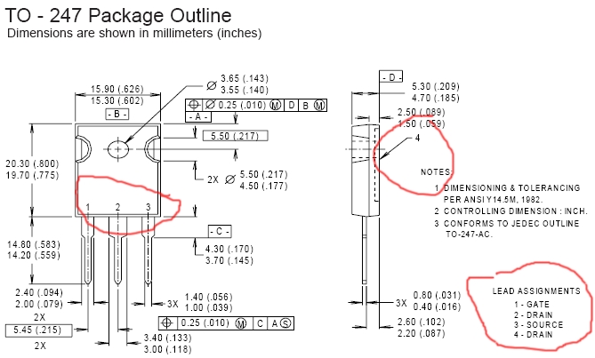

Correct: see http://www.irf.com/product-info/datasheets/data/irfp3703.pdf page 8
Remember that the metal tab is also connected to the drain so be careful how you mount it

Peter,
  Thanks for the reply.  I have looked at that data sheet probably 10 times, but I couldn't
seem to locate where it says what the pin assignment is.  But, I just saw at the very bottom,
in the right corner of the last page, where it lists the pin assignments.
Thanks, Mike
From what it appears, from the TO247AC description (the MOSFET's case),it looks like pin #1 is the gate, pin #2 is the drain, and pin #3 is the source,Mike Welch

Don't need to assume anything. Here's a view I captured from
the data sheet.
[img]cid:7.1.0.9.0.20100924080214.01230128(at)aeroelectric.com.0[/img]
 Filesize:  122.7 KB
 Viewed:  4552 Time(s)
mdnanwelch7(at)hotmail.co
PostPosted: Fri Sep 24, 2010 5:49 am    Post subject: pin confirmation Reply with quote
Thanks Bob!
