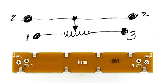

PostPosted: Thu Sep 23, 2010 10:40 am    Post subject: Potentiometer , 3 lugs Reply with quote
At 12:09 PM 9/23/2010, you wrote:
--> AeroElectric-List message posted by: "jonlaury" <jonlaury(at)impulse.net>
Thanks Joe,
My slide pot has pins 1,2,3 at one end and 1,2 at the other. I got joy when I connected pins 1 at one end and 2 at the other. The 5K range was displayed on my meter when I moved the slider. I assumed 1&2 to be the pos/neg pins. Assuming that pin 3 was the signal pin, I put the meter between 1& 3 and got nothing and my brain hit the wall because of my assumption that 1&2 were the pos/neg pins..
Pin numbers or other markings not withstanding, the
functionality of slide pots yields readily to
inspection.
For example, in this device:
[img]cid:.0[/img]
. . . I would have guessed that "2" and "2" on each end
are connected internally to each end of the wiper's
slip-track. 1 and 3 would be the ends of the pot's resistance
element. I suspect that an ohmmeter inspection of your device
will show that all pins of like number are connected to each
other. The cluster of 1,2,3 at one end is conducive to hooking
the pot up with a twisted trio or some such. So it's
probably unimportant which "1" or "3" you connect to, functionality
will not be affected. Either 1 or 3 can be (+) or (-) and
that will be determined by whether or not the indicator reads
in the right direction. Installation instructions for use
of this pot SHOULD be explicit in this regard. But if not,
then be prepared to reverse 1 and 3 connections if the
operation is 'backwards'.
