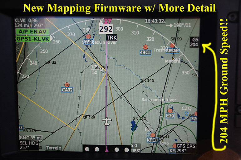

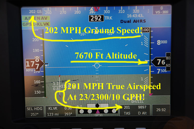

I have an IO-390 with a 72" Hartzell on the RV-8 and just this weekend was experimenting with slightly higher RPM settings than I've been running. At 23/2300 (at) 7500ft I was seeing 10 GPH / 20.3 MPG / 201 MPH True. See attached photos of the EFIS displays.
Matt Dralle
