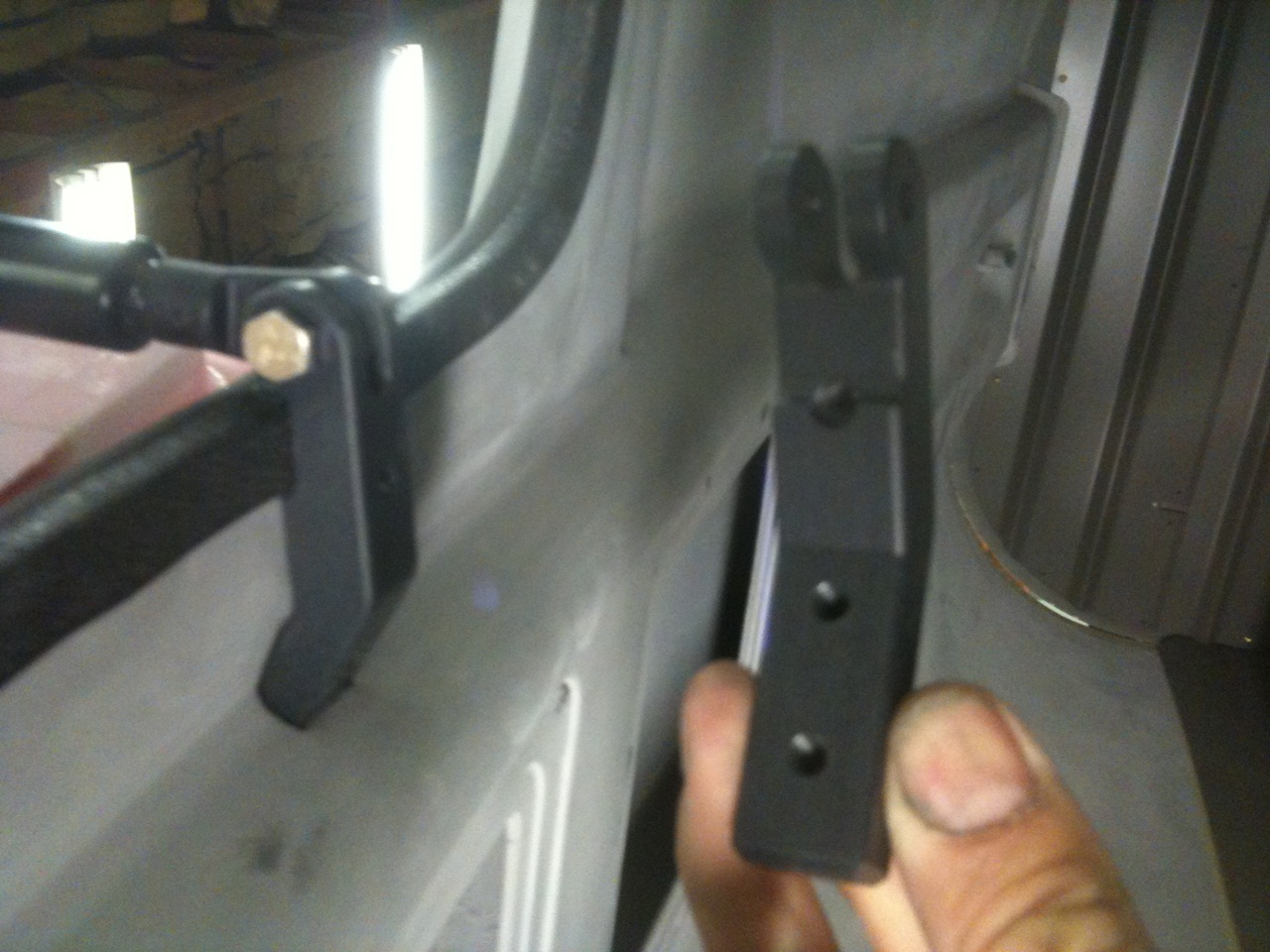

The brackets have been machined so the mcmaster seal can slide on the cabin lip under the bracket. The bracket fits over the seal it does not squeeze it. It is also lowered a little bit without changing the geometry so if you have flat hinge covers they don't interfere.

It drops the mount point for the strut down about 1/4" so that it clears the
McMaster-Carr door seal.
