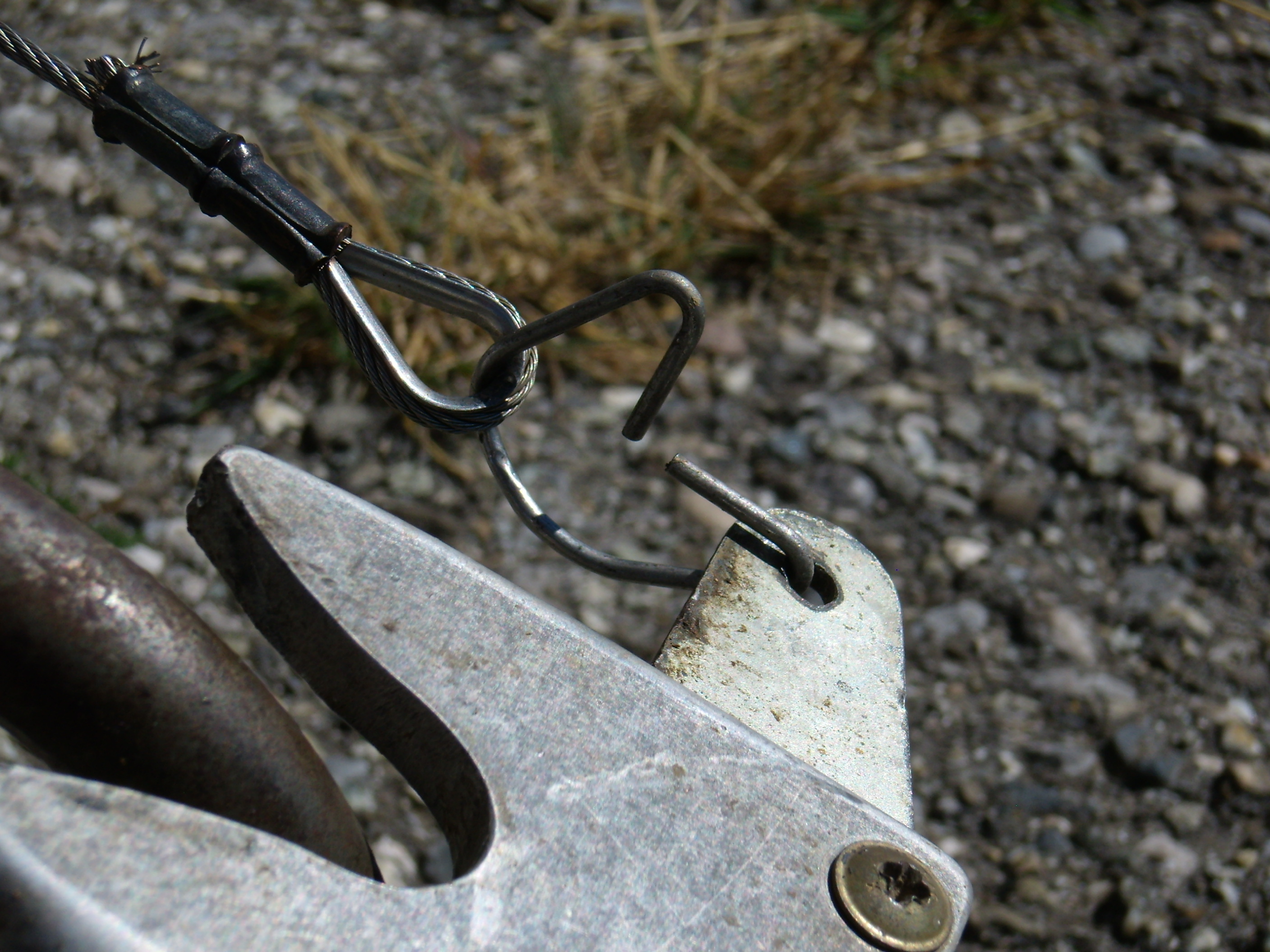

Hi all monowheel drivers,
After landing on a mountain strip today I noticed I had some trouble
controlling the aircraft on roll out and tight turning on the
parking. The next landing on another altiport was uneventful but
again I had trouble tight turning to the parking spot.
During the preflight check for the return flight, this is what I
found: the starboard ring attaching the cable of the tailwheel fork
was open and was barely insuring a very loose connection. See attached
picture.
I am afraid that if that ring had become fully disconnected, I would
have crashed into the wall of rocks on the left side of that runway!
Lesson learned: check that tailwheel control cables carefully before
EVERY takeoff.
Of course I am thinking at some solution to insure a safer connection
of those cables.
Remi Guerner

Hi Remi,
Another way to attach the cable is with a shackle (AN115) and clevis pin.
This is working well for me so far.
Glad to see it did not let loose completely!
Kevin

PostPosted: Sun Sep 12, 2010 3:02 pm    Post subject: Tail wheel control cables attachment Reply with quote
Remi,
Loose the clips! Replace them with AN115 Cable Shackles, Clevis Pins and a Cotter Pins (split pin).
http://www.aircraftspruce.com/catalog/appages/an115.php
http://www.aircraftspruce.com/catalog/hapages/clevispins.php
http://www.aircraftspruce.com/catalog/hapages/cotterpins.php

PostPosted: Sun Sep 12, 2010 10:55 pm    Post subject: Tail wheel control cables attachment Reply with quote
Hello Remi,
Yes, I had the same problem 9 months ago after about 80 hours. I also
noticed poor steering and found the same problem. I emailed John Wheeler
and he told me that they have now changed to a mini U bolt (like the
u-bolt and screw pin used to secure the safety chain on a trailer) to
connect the cables to the tailwheel assembly as they have seen that
problem before. Maybe those wire connectors should all be changed.
Keith.

PostPosted: Sun Sep 12, 2010 11:44 pm    Post subject: Tail wheel control cables attachment Reply with quote
Bob's right. This has been a common problem over the years. Use the AN115 shackles.
Graham

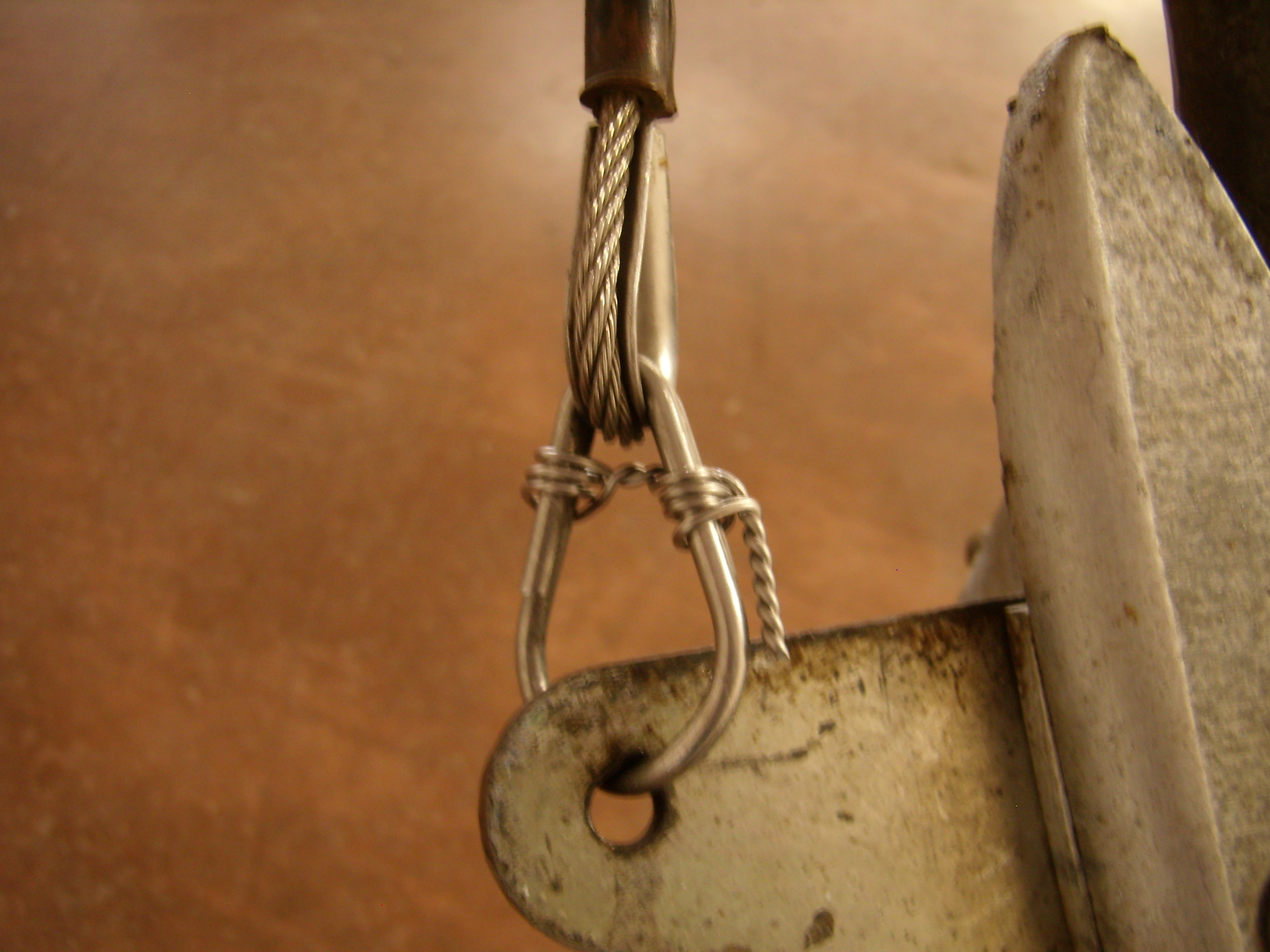

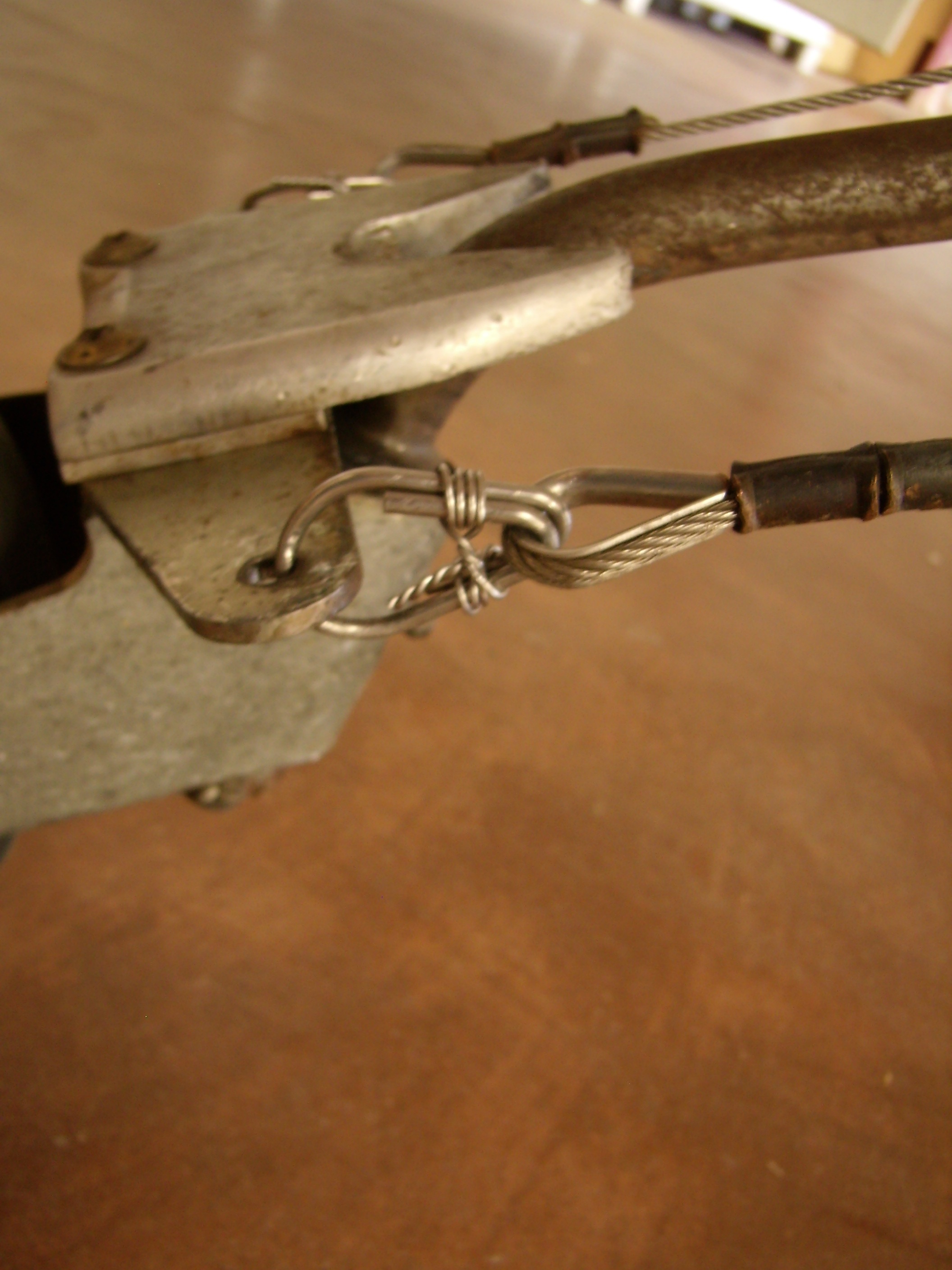

PostPosted: Mon Sep 13, 2010 12:12 pm    Post subject: Tail wheel control cables attachment Reply with quote
Thanks to those who have made suggestions for the replacement of the
clips. I like the Shackles + Clevis Pins solution.
Attached are two pictures of my temporary fix.
Remi

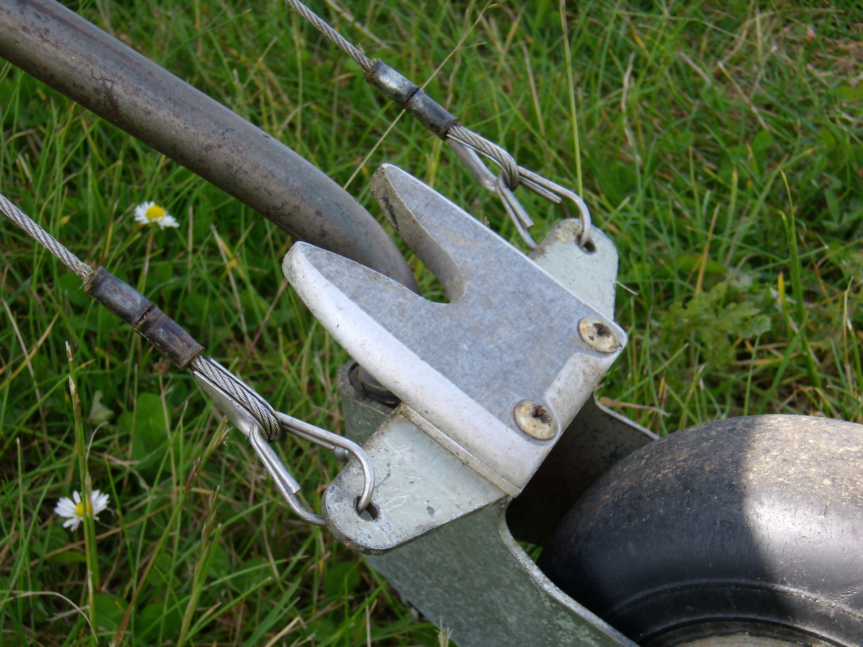

PostPosted: Mon Sep 13, 2010 12:44 pm    Post subject: Tail wheel control cables attachment Reply with quote
Hi Ron,
Thank you for your suggestions. However, having no tail wheel stop is
not good. While pushing your aircraft backwards, the tailwheel will
turn 180 degrees or more and your rigid turnbuckles will be
dangerously damaged. Same thing may happen when landing in a crosswind
with the rudder (and therefore the tailwheel) deflected. When
contacting the ground, the tailwheel is violently pushed to the
opposite position and again your turnbuckle may be damaged . The
Singleton stop is a lot better than the original XS stop (a rolled pin
which breaks after a few dozens landings), but as I saw several
Singleton stops damaged by the beating they take, I designed a
stronger copy (see attached picture).
Remi

Remi,
Bob may have been using the colloquial phrase "ripped off" to mean
that he copied Graham's design rather than that he removed it.
Fred

PostPosted: Mon Sep 13, 2010 9:17 pm    Post subject: Re: Tail wheel control cables attachment Reply with quote
Hi Remi
When I mentioned I "ripped off" Grahams designed of his tailwheel stop, I meant that I copied his design.
I did in fact fabricate it from 7075 Aluminium that is quite robust.
http://www.mcmaster.com/#about-aluminum/=8u6cpz
http://www.europaowners.org/forums/gallery2.php?g2_itemId=28015
http://www.europaowners.org/forums/gallery2.php?g2_itemId=28009
What material did you make your stop from?

PostPosted: Mon Sep 13, 2010 11:37 pm    Post subject: Tail wheel control cables attachment Reply with quote
Ron & Remi
don't forget that its better to bend the tailwheel stop than bend the leg. That's why I used soft aluminum
Graham
