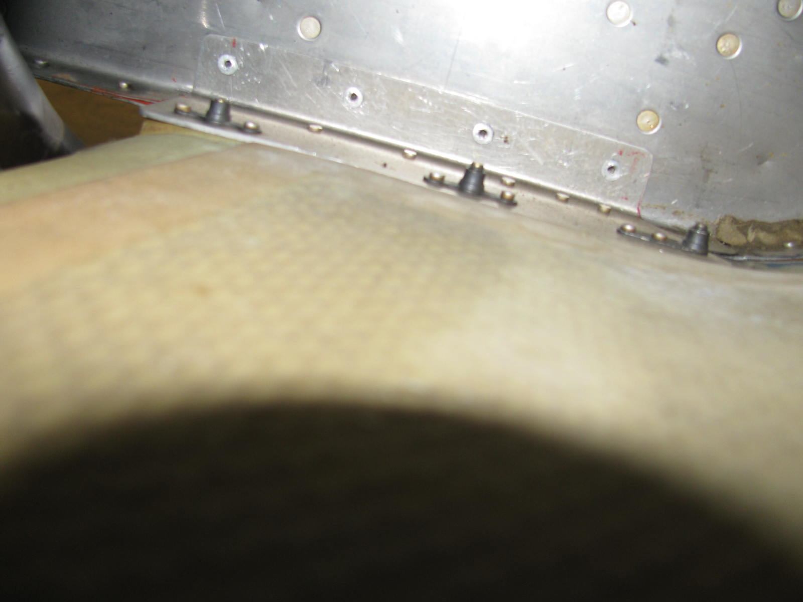

My hinges failed after about 100 hours.  I installed extensions with 3 nutplates on each of the existing lower flanges.  I used the original holes from the hinge rivets.

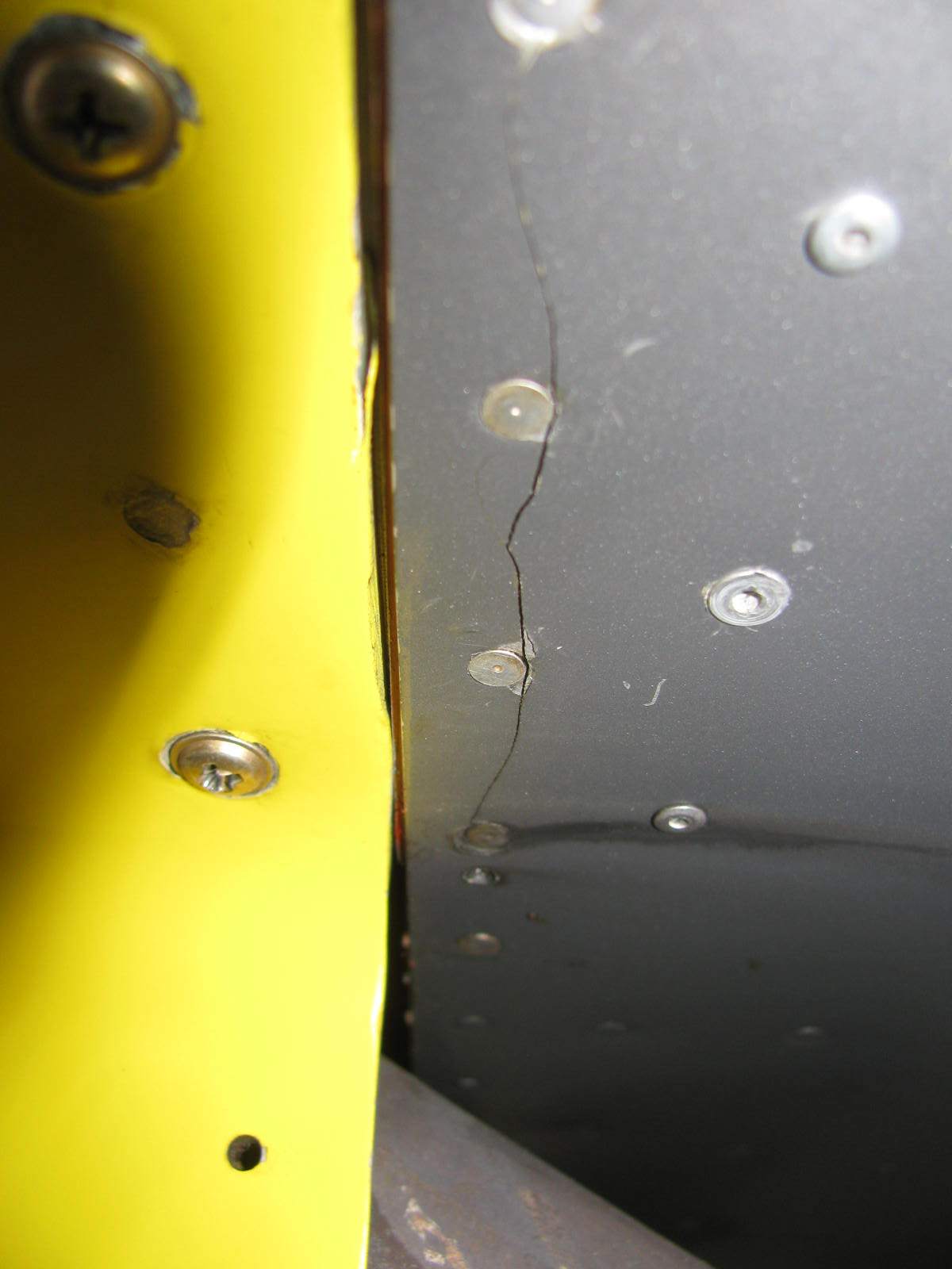

After about 500 hours the plane developed a small crack in the lower skin immediately aft of the extensions.  We were able to get a doubler between the firewall and the skin, and rivet it in place with blind rivets.  We couldn't get to the back of the skin without removing the pilot's floor board (grimace here) or at least installing a nasty access panel.

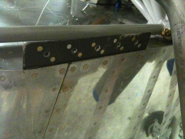

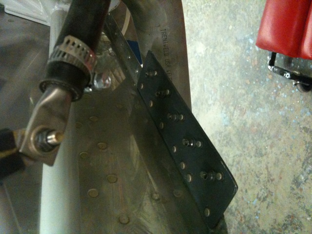

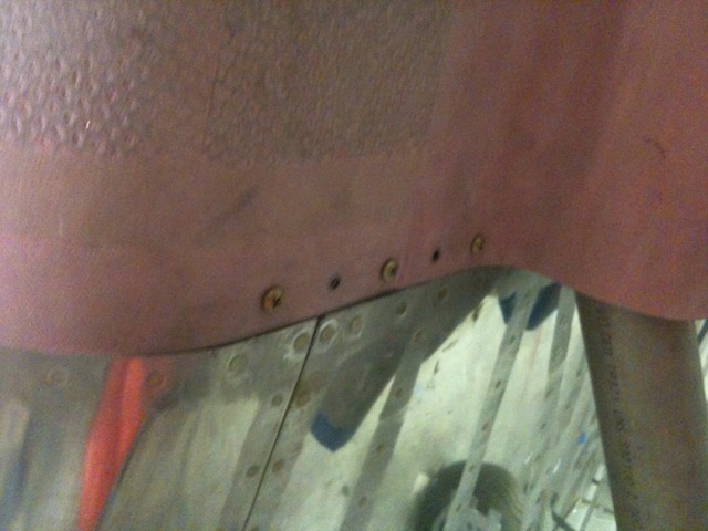

Here is what I did. I replaced the rivets with AN426-4-5 rivets instead of the An426-3's that were there initially.
