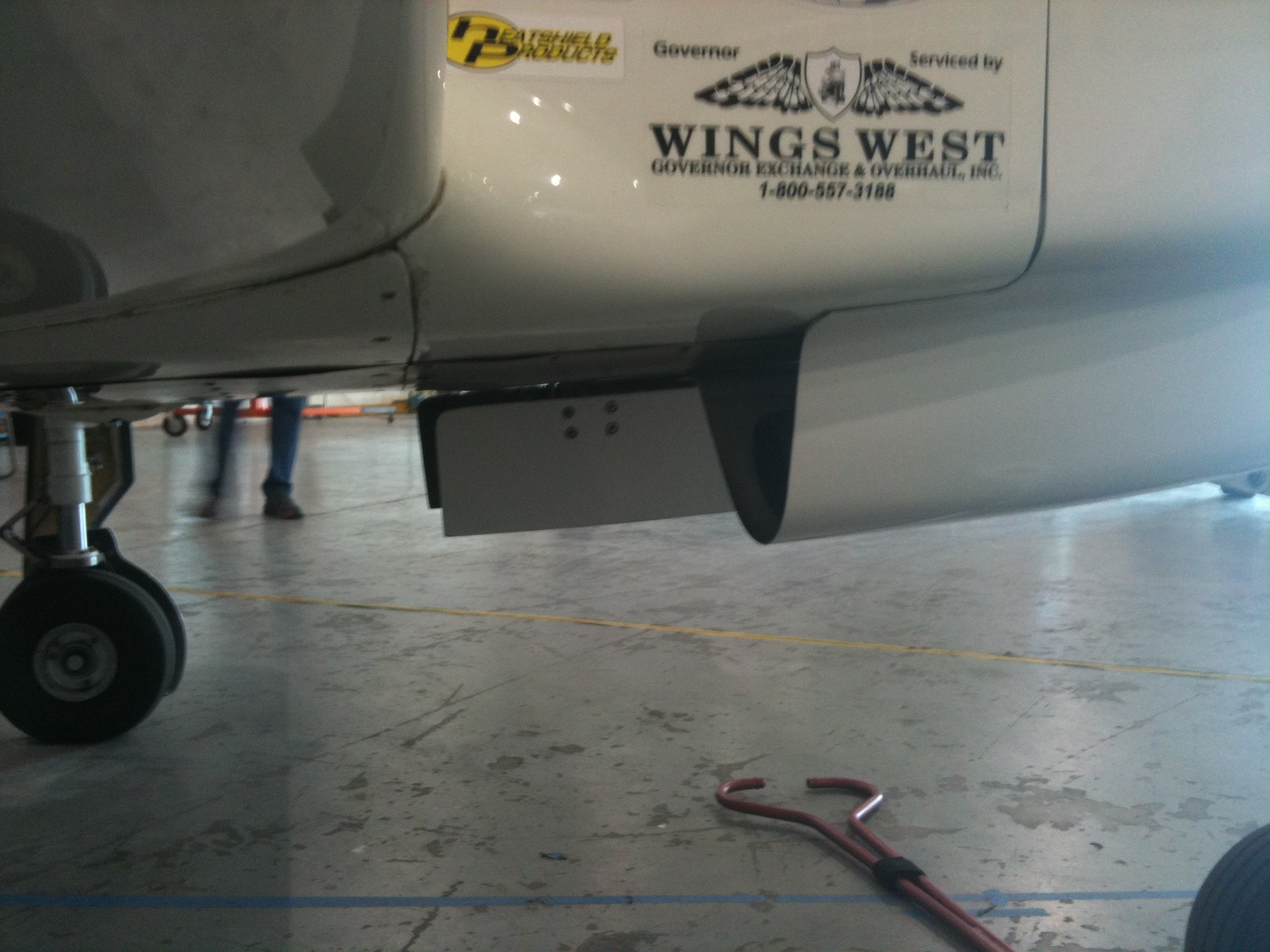

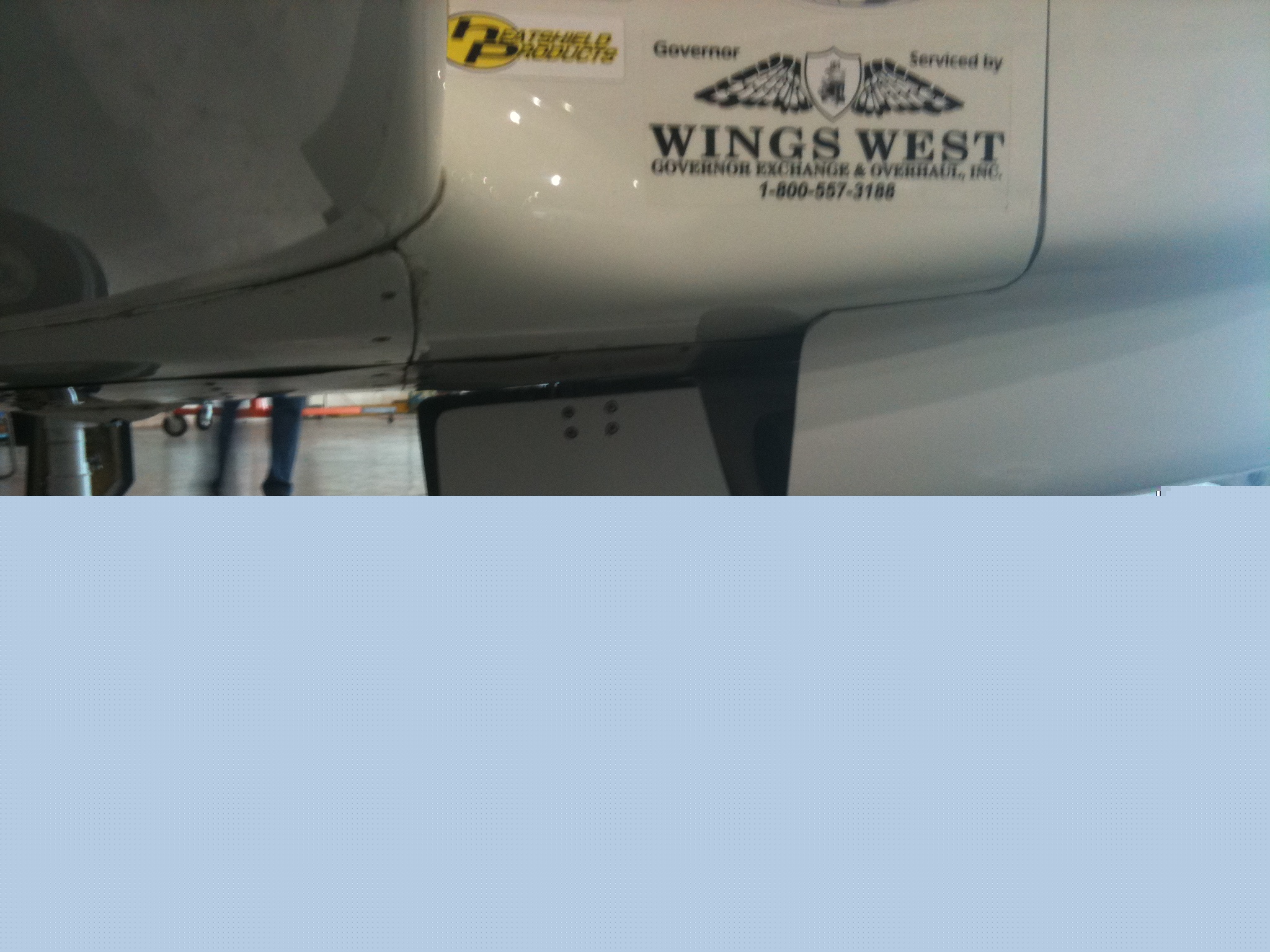

The first pic is a Glasair. He had the same engine (Lycon) as many other sport planes. He was the last one around the track. I tried this cooling exit ramp. It doesn't work.

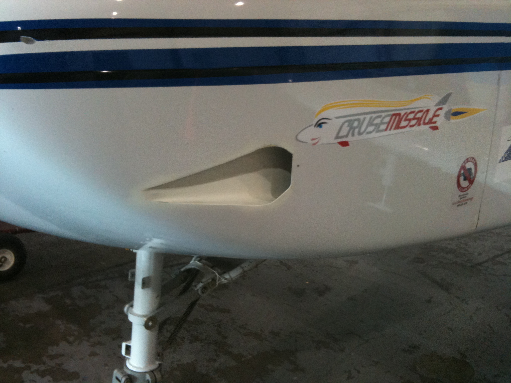

The second pic is a wanna be NACA scoop. I really wanted to just write "See NACA ACR No. 5120" on the plane.

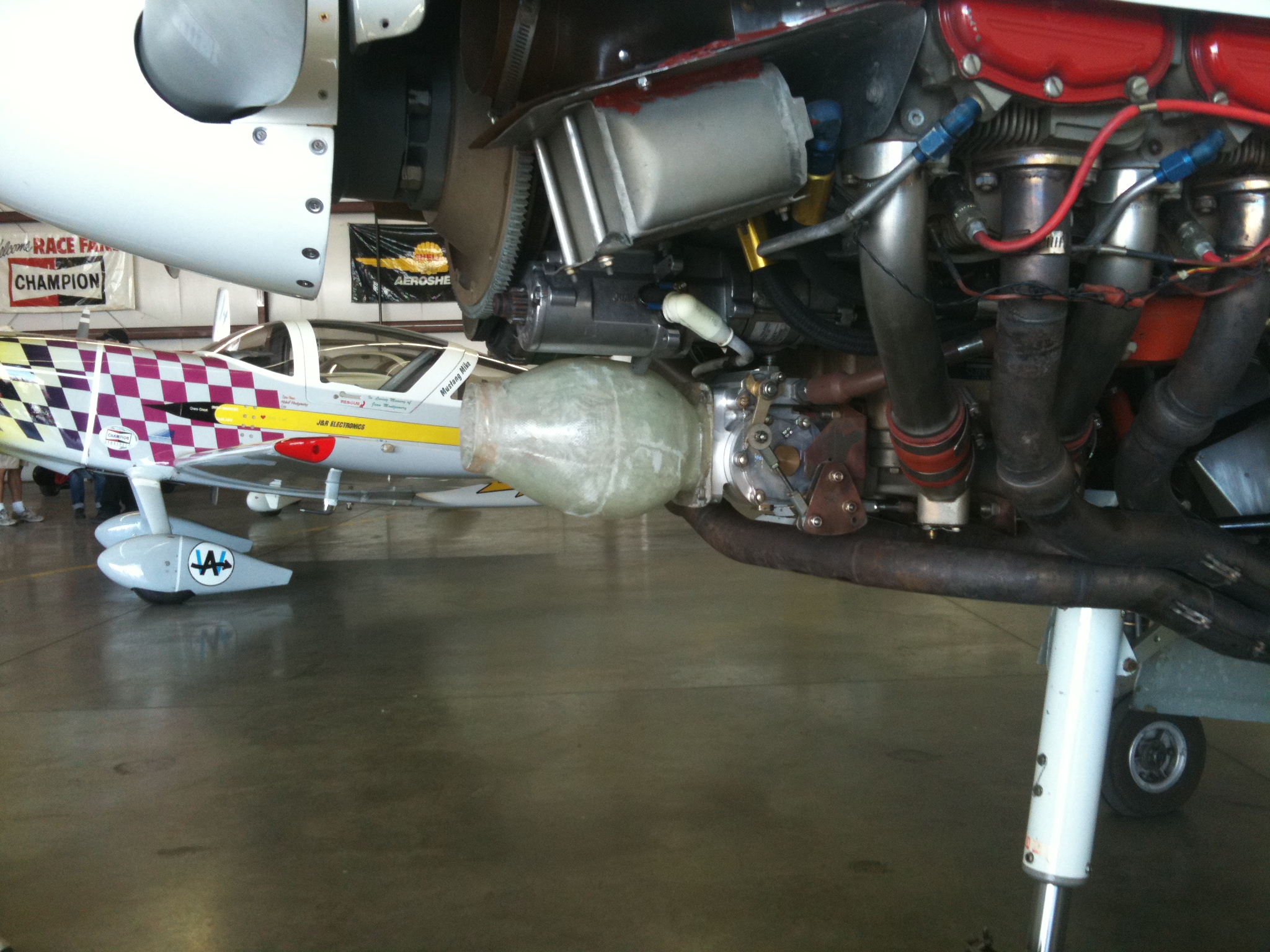

The third pic is a throttle body inlet. Now, this guy did his homework.

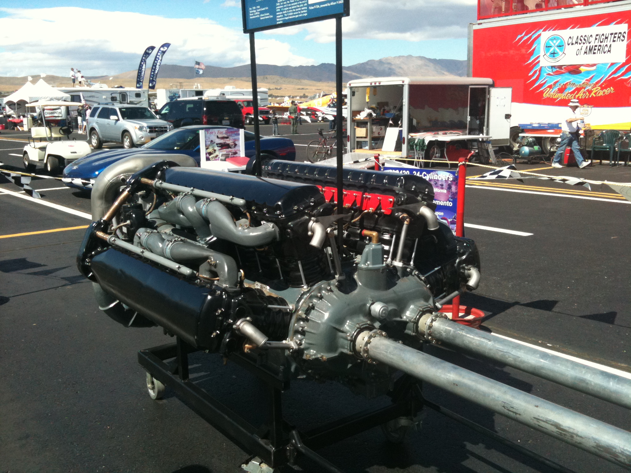

I had to include this. The description says it's a V-3410. If you read the book, Allied Aircraft Engines, you see it's a W-3410. 2600 hp.

Allison engines were cool. While not as highly regarded as the Merlin, they were well designed and assembled. Allison went as far as taking the basic V-1710 and turbo-compounded it, naming it the V-1710-E22. Normal max power was 2300 hp with over 3000 hp available for War Emergency. Shame it never came into service.
Would you explain what you like about that inlet?
