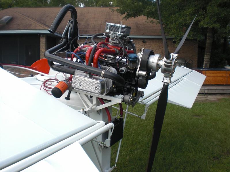

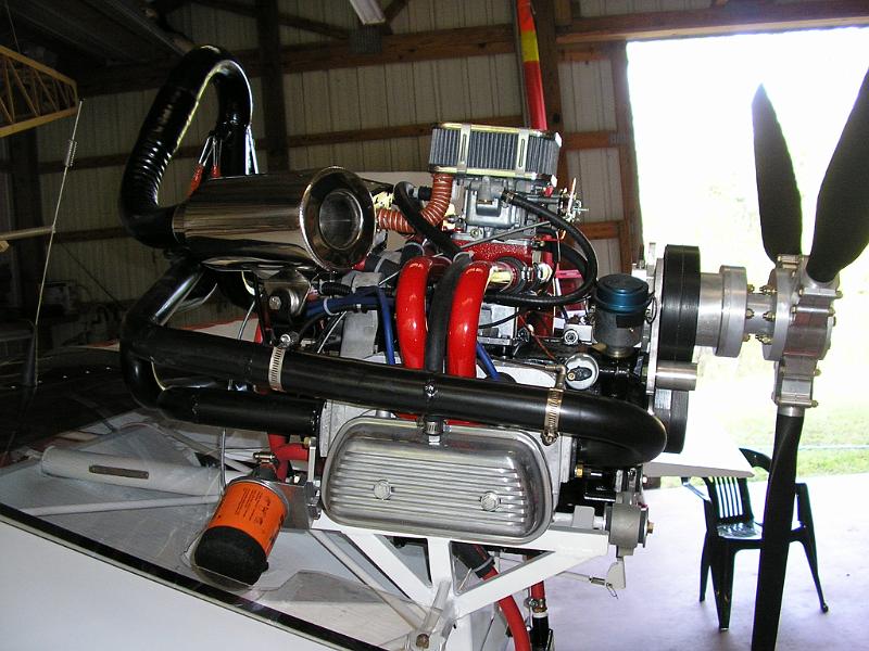

In the matter of the Corvair engine... Weight and prop tip speed are definite negatives on a MKIII. The Great Plains VW conversion with a re-drive from Valley Engineering are a good option. Rick Neilsen has flow his VW re-drive as a pioneer for over ten years. Craig Spoke is happy with his MKIIIX with VW and I am moving toward finishing my MKIIIX using the GPAS VW with re-drive within the next few months. My 2180cc engine develops 103hp (at)4200RPM Take-off power and cruises (at) about 3200 RPM. It has dual ignition. The Kolb facotry is working very seriously toward offering the VW conversion as an engine option.
Just my opinion...
Bob
N830PB

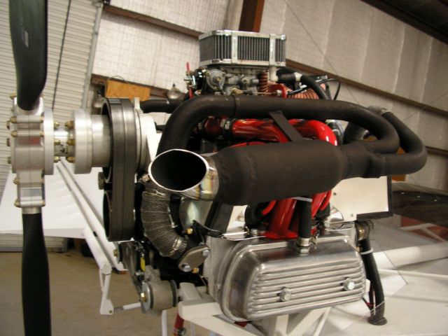

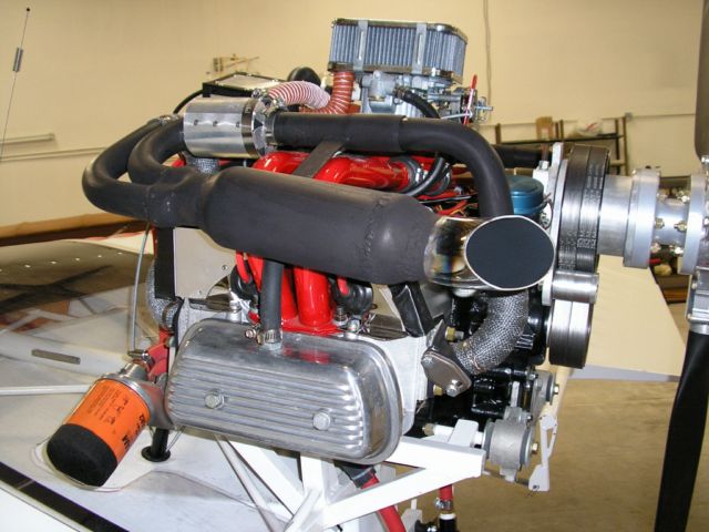

Bob, You are correct. I am very pleased with the engine setup on my Kolb. Thanks for posting the pictures of my engine however I have since changed the exhaust. I was not happy with the drag and weight of this exhaust. He new setup is more compact and weighs 10 lbs less.
