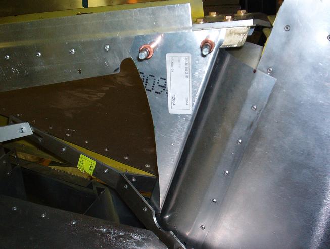

The drawing for the stab trim tab fork shows a semicircular cut out for "something". The reference is part 2. Can anyone tell me which part I need to reference the fork to in order to make the cut out in the proper location?

Here is a photo. The cutout is for the curved trim piece in front of the rudder.
Steve

Thanks Steve. Nice photo. I'll leave it alone till I do final assy.
