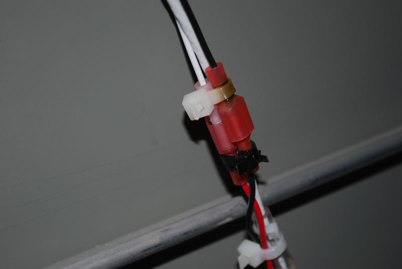

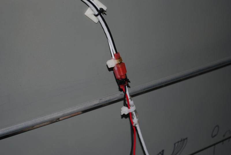

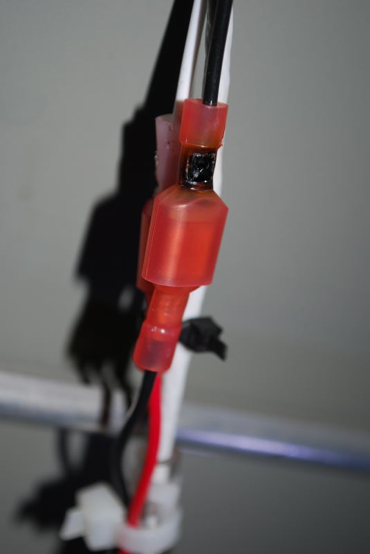

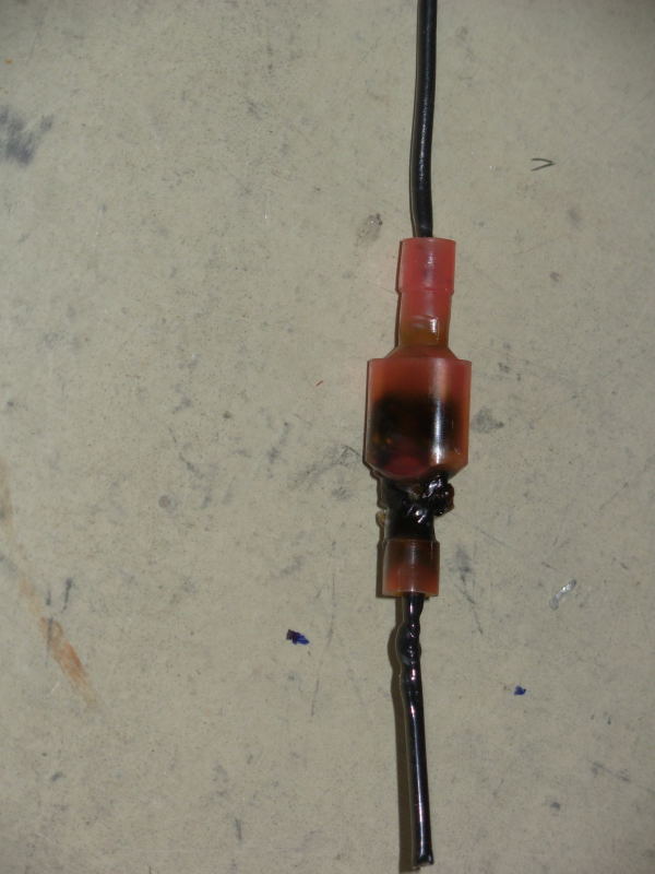

On initial failure at approx 50 hrs, I found the ground return wire for main
power plug to power supply to have overheated, melting the wire and
connector where my aircraft wiring met the factory harness pigtail (see
attached photos with "50hrs" in file name).
From the looks of the overheated connector for ground return wire, I assumed
I had inadvertently cut wire strands when stripping insulation for connector
installation, leaving not enough wire guage to carry the expected 7A
current, thus overheated the connector. So I removed the damaged wire,
replaced connector with same style (being very careful not to damage wire
strands and to get a good crimp), and tested strobes with no issues.
Everything worked fine until strobes quit firing again at about 150 hrs
total time (approx 100 hrs since first issue).

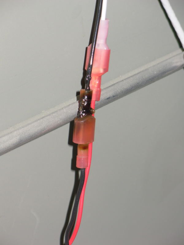

On inspection after the second failure, I found the same connector/crimp to
have visible heat damage but not to the extent of melting to an open like I
had the first time. The resistance across this heat damaged connector was
about 0.8 ohms, but not open (measured after cutting wires on either side
of the connector without disconnecting the spade terminals). See attached
pictures with "150hrs" in file name for what it looked like this second time
around.

Some other pictures of power supply wiring runs and installation are at:
http://rv6aproject.ckhand.com/panelAndElectrical/electrical/electricalPg6.htm and 3rd picture down on this page: http://rv6aproject.ckhand.com/panelAndElectrical/electrical/electricalPg8.htm#photo3 Any ideas, or something I might be missing? Thanks, ChrisRV-6A, N731CK

These appear to be localized to the crimp area.
You could try solder type quick disconnects with heat-shrink tubing as the insulator to see if that truly is the issue.

Agreed. Without having the carcasses to
conduct detailed autopsies, the best guess
is these are (1) non-PIDG terminals (obvious)
installed with (2)a tool that failed to produce
a gas-tight junction between wire and terminal.
An alternative or even a concurrent condition
may be that the interface between male tabe
and female fast-ons are weak. Poor alloy selection
in the fabrication of the terminal could contribute
to both failings.

Many List members will recall some discussions we had
a couple years ago about switch failures . . .
http://tinyurl.com/2a2qqp
Go to the http://matronics.com/search and check
the AeroElectric archives for
carling switch failures
from the time a wire approaches one of these
switches until it winds its way off to new
adventures there's a substantial string of
metal-to-metal joints in series with the
current flow.
(1) wire to terminal grip
(2) fast-on grip to fast-on tab
(3) fast-on-tab to rivet head
(4) Rivet to saddle
(5) saddle to rocker
(6) rocker to contact
(7) contact to contact rivet
(Cool contact rivet to fast-on tab
(9) fast-on grip to fast-on tab
(10) wire to terminal grip
In the case of Carlings, the most mechanically
fragile are 3, 4, and 8 because clamp-
up forces on the joints come against
plastic housings. The most environmentally
fragile are 5 and 7 because they cannot
strive for gas tightness.
Unfortunately, there are stresses
on the gas-tight interfaces that can degrade the
joint including process (wrong tool or
inadequate workmanship), materials (poor
choice of alloys, plating, etc), environment
vibration opens joints, moisture gets in,
etc) and even perhaps design (rare).
Once any of these joints is compromised,
it's resistance goes up, electron flow and
physical heating combined with moisture
and oxygen promote corrosion which further
degrades mechanical and electrical integrity
of the joint. It's a slay-ride down a steep
hill after that.
The most demanding circuit in the airplane
is strobes. 5-7 amps, continuous duty for
duration of flight.
When these failures are observed, there IS
an explanation that is rooted in failure to
maintain very low ohmic contact between
all the pieces and parts. Failures can
begin in any one or any one or combination
of the ten joints cited above.
Failures cited at the initial posting of this
thread have one-for-one commonality with
failures and probable causes explored in the
discussion on switch failures last year.

I do still have the second carcass (the less damaged one from 150 hr
point) and it's possible I might have the original melted one if I
didn't lose or toss it when I moved my plane and hangar contents to a
different airport a few months back (E16 to KRHV move in San Jose, CA
area). I didn't cut the crimp area to look at cross-section but the
fast-on tabs looked normal and the grip strength was good when I
seperated the male and female sides after checking resistance across
the connector. I'd be happy to send you the carcass I have, or both
if I can find the first one, if you're interested in examining the
crimps and connector.
Yes, I'd like to do that.
Localized heating as demonstrated by color of
the insulation tells us the failure was loss
of gas-tightness in that area. We only need
to deduce root cause.
The crimp tool I used was a ratcheting AMP ProCrimper I bought from
Chief Aircraft prior to starting the electrical system. I used it
throughout construction and have had no problems with any other connectors.
But are the fast-on terminals also made by AMP?
The total bulk of insulator, sleeve, terminal
material and strands of wire controls how much
pressure the tool brings to bear on the joint.
If you have more of the same terminals, crimp
a couple of terminals onto a scrap of the same wire
and send that too.
My error may have been the Home Depot / Fry's connector source but
I haven't seen anything obvious on these two particular
crimps/connectors that would lead me to believe they shouldn't have
been able to handle the expected 7A load.
Oops . . . current doesn't have much to
do with joint failure . . . only the RATE
of degradation once gas-tightness is lost.
These kinds of failures DID NOT initiate
in the few hours preceding events that brought
the failures to your attention.
Inadequate installation or improper mating
of parts, materials and tools may have given
you incipient failures that started marching off
toward overt failure in the first hours of flight.
One problem I've seen on fast-on terminals with
indeterminate pedigree is the alloy. Some copper
alloys are NOT capable of sustained mating forces
over time, vibration, temperature cycles.
Assuming Whelen is correct that the power supply is operating
properly then clearly in both the 50 hr and 150 hr failure, that one
single crimp was inadequate, at least over time, resulting in
significant overheating. I just don't understand why yet.
Let's see if we can figure it out.
