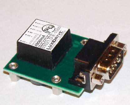

You must be reading the information published
concerning noise issues on POWER SUPPLIES used
to excite high intensity arrays of LEDs.
[img]cid:7.1.0.9.0.20100905122859.01ec16d0(at)aeroelectric.com.0[/img]
In this case, it's the electronics that becomes a
potential antagonist for sensitive victims. It was
a potential cum reality that prompted a re-packaging
of the LuxDrive power supplies on a filter board
as shown above.
Does using a couple of LED's with the appropriate resistor create noise antagonists?
The LED is probably 10x noisier than other diodes . . .
but take that with a grain of salt. Virtually ALL electronic
devices passing current generate some noise. But
in the case of diodes, resistors and such, the amount
of is so tiny as to require special receivers
just to go find it . . . the garden variety
instrumentation system wont know it's there.
So install as many LEDs and companion resistors
as needed to meet your design goals. Noise potential
has no practical significance.
