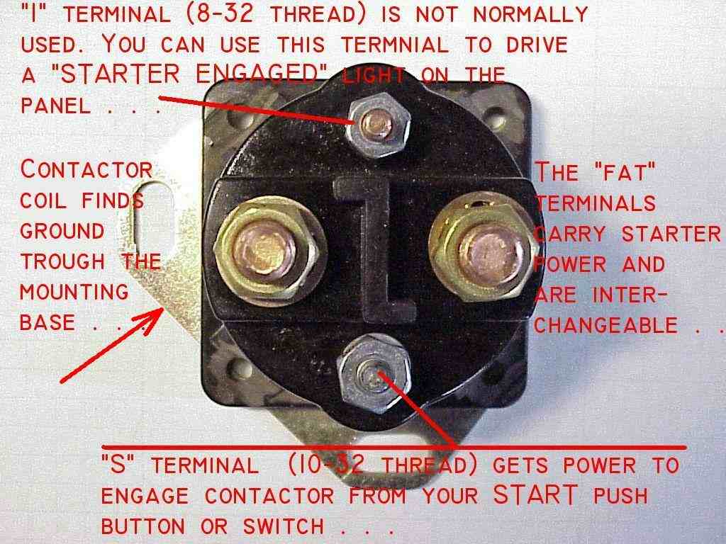

PostPosted: Sat Sep 04, 2010 9:43 am    Post subject: An Easy One Reply with quote
At 10:59 AM 9/4/2010, you wrote:
My starter contactor is the type that has two small terminals in
addition to the two large load 5/16" terminals.
I want to make sure that the spike catching diode is to be installed
across the "I" and "S" terminals so that the banded end of the diode
faces the S terminal and that there's a jumper from S to the hot
side of the 5/16" terminals.
???? What diagrams are you looking at? if your starter
contactor looks like . . .
http://www.aeroelectric.com/Pictures/Contactors/s702-1l.jpg
it MAY already have a diode installed. Look on the bottom
mounting flange. It might be marked "diode protected".
If not so marked, then the banded end of the diode
goes to the "S" terminal. The other end of the diode
goes to one of the mounting base bolts.
And does it matter which terminal (I or S) receives the switch leg
of my START button?
VERY much, the "S" terminal goes to the switch.
I plan to use the I terminal for a stuck starter light.
Good.
