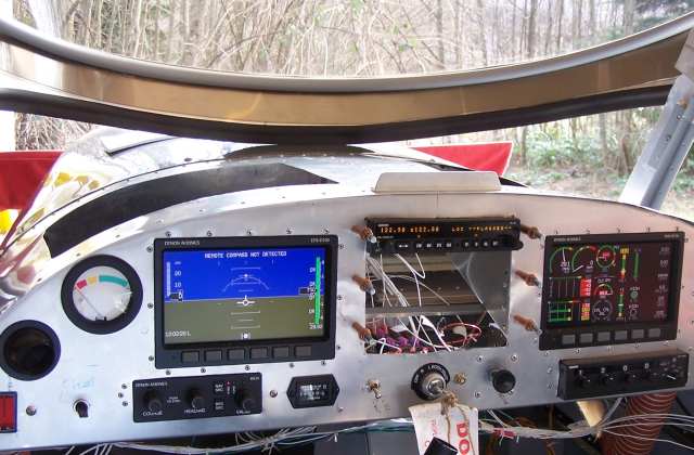

I found a slightly different way to accomplish the same goal you have. I cut two large inspection holes and made corresponding plates to cover them. This gives me relatively complete access to the area between the firewall and instrument panel without messing with the longerons or other structural components.
A picture is worth a thousand words:
