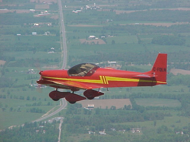

I made rigid foam forms on the a/c, coated them with epoxy and then cast the fibreglas fairings with flanges for the wing and fuselage surfaces. Fashioned after the Spitfire wing fairings, going back along the fuse about 14 inches from the wing trailing edge.
They did improve air flow over the horizontal stab. and the elevators
Dave Austin 601HDS 912

Att. is a pic of my 601 with the fairings - not a closeup, but you can see them.
Dave Austin

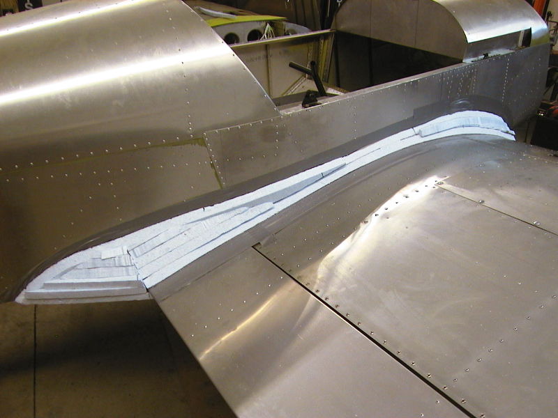

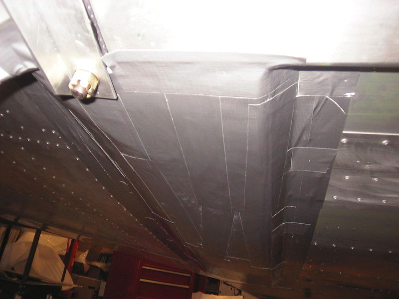

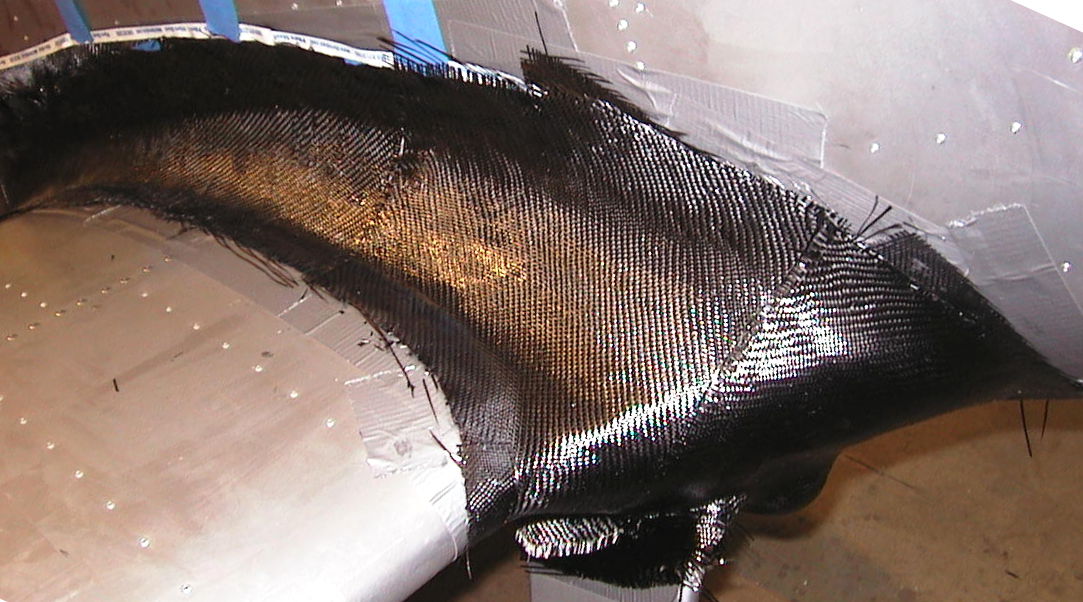

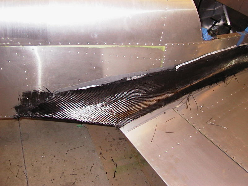

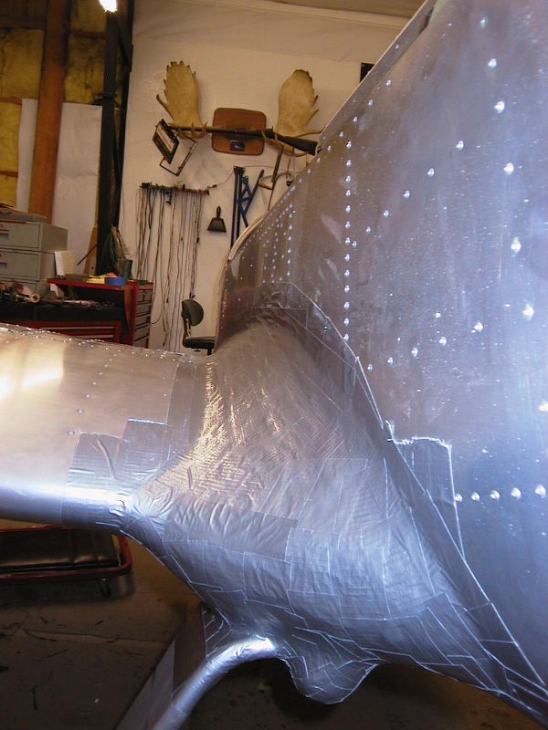

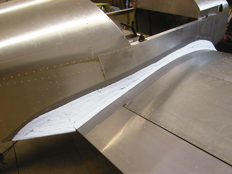

I'm fabricating top and bottom fairings for my 601 XL. The airplane isn't finished yet, but from an aerodynamic point, it is evident that the fairings should help quite a bit. It doesn't take a huge amount of specialized skill, but does take more time than I expected. I fastened 1" thick foam sheets (the foam that the QB kit was packed in) to the airframe with double sided tape. That type foam isn't the best for forms because it isn't very dense, but it was available and I had no other use for it. Additional sheets were stuck to existing sheets with double sided tape or small dabs of epoxy adhesive. The foam was shaped with Stanley Sureform files, sandpaper, hot wire foam cutter, electric chainsaw, etc. Irregularities, and gaps, were filled with modeling clay. Then, I coated the foam with epoxy for stiffness. After that was cured, I covered it with duct tape and made sure the duct tape was extended a few inches outside of the fairing area so no epoxy would get on the skin. Epoxy doesn't stick to duct tape, but some mold release on the tape helps with de-molding. Mold release can be paste wax, or even spray on cooking oil, or Pledge furniture wax. Thanks to Jake Reyna for the duct tape covering of the foam idea. It's a good solution.
Cut the glass or carbon fiber cloth to shape leaving plenty of excess on the edges. I put a coat of resin on the form using a small roller or brush. Lay the cloth over the form and work the cloth into the epoxy on the surface. Use more epoxy if you have to for wet through, but not too much. If you use a brush, cut off about 1/3rd of the length of the bristles so they are stiffer. Push the cloth into the epoxy with short vertical jabs called "stippling". There shouldn't be so much resin that it puddles, and the weave should show. I used three three layers of 6 oz/sq yd carbon fiber twill cloth. Glass cloth is less expensive, but heavier and not as stiff. It's likely you can't make the layup in one piece as it gets quite unwieldy. Overlap the separate pieces by about 1 1/2". Leave the layup on the mold until the epoxy has fully cured. This might be a couple of days. De-mold by starting on an edge by working a putty knife under and edge and getting it lifted. At first it will appear to come off with difficulty, but after some has broken loose, it's likely the part will fall off. Making a part from a male mold as I've described will leave a somewhat uneven and rough surface. Depending how you want to finish the fairing will determine how it's made smooth. If painting, use a lightweight filler made from epoxy and microballoons (glass beads). You could use lightweight polyester body filler too. Then sand and paint. I made mine from carbon fiber cloth and intend to leave it natural. I painted on another coat of epoxy to fill the weave and sanded most of that off. Another coat of epoxy and more sanding using finer grit. I'll finish with urethane automotive paint clear coats for UV protection with sanding between coats.
Polyester resin could be used instead of epoxy. Epoxy doesn't shrink like polyester does, and epoxy is a much better adhesive than polyester. I used epoxy that is good to over well over 200 deg F since the top fairings will be out in the sun. I used epoxy system 2000 from Fiberglast. http://www.fibreglast.com/ They have hardeners in 20 min, 60 min, and 120 min setting time. Epoxy resins are available from other sources that will work too.
Rear of fairing done.
 Filesize:  84.24 KB
 Viewed:  27824 Time(s)
Front of layup done.
 Filesize:  136.97 KB
Right wing front fairing covering gear attachment. TD gear.
 Filesize:  86.65 KB
Top fairing mold nearly done
 Filesize:  64.21 KB
Top fairing form construction
 Filesize:  69.55 KB
Under wing fairing form covered with duct tape.
 Filesize:  57.7 KB
