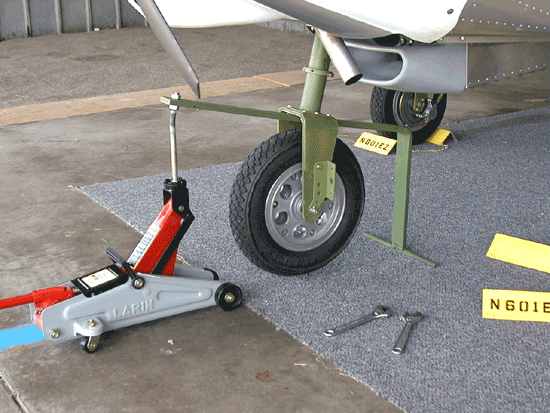

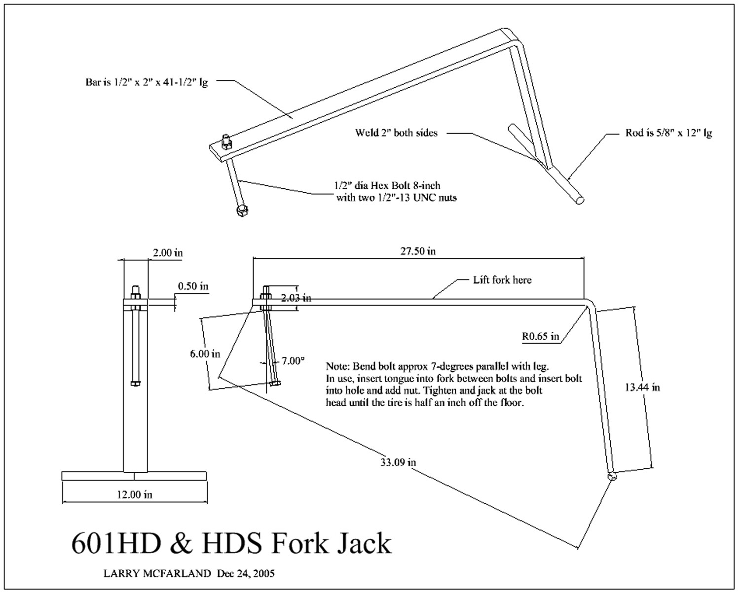

Ron,
Here is an ideal on how to jack up the front end from Larry Mac's site.
After you jack it up you can rest the front end on some kind of support.
I modified this idea to change tires on my 601.
Hope this helps.
Jerry
