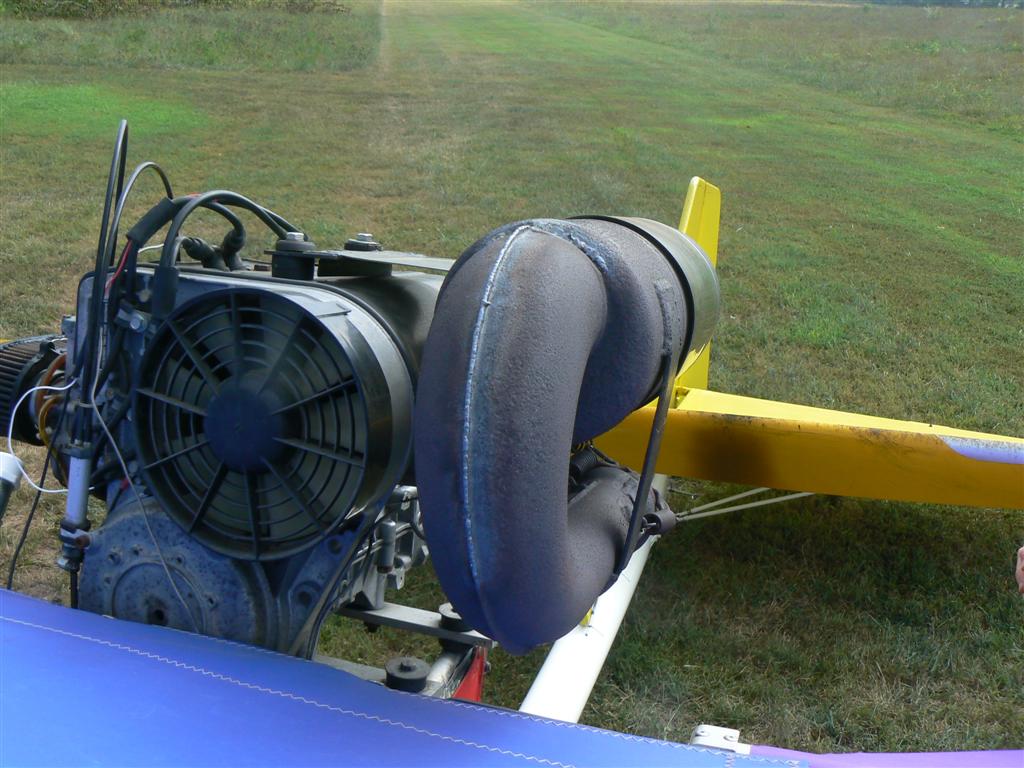

Several years ago when I still had the 532 on my MKIII, I was on the way home one afternoon when suddenly the exhaust became incredibly louder. My wife heard the noise when I was still a couple miles away. Got home and discovered that one side or half of the curved expansion section had blown loose. It had failed so badly that the only thing still unbroken was the area next to the inlet cone.
Welded it back and mentioned it to a friend, and as it turns out, the same thing had happened to him, it was the 503 on his Drifter.

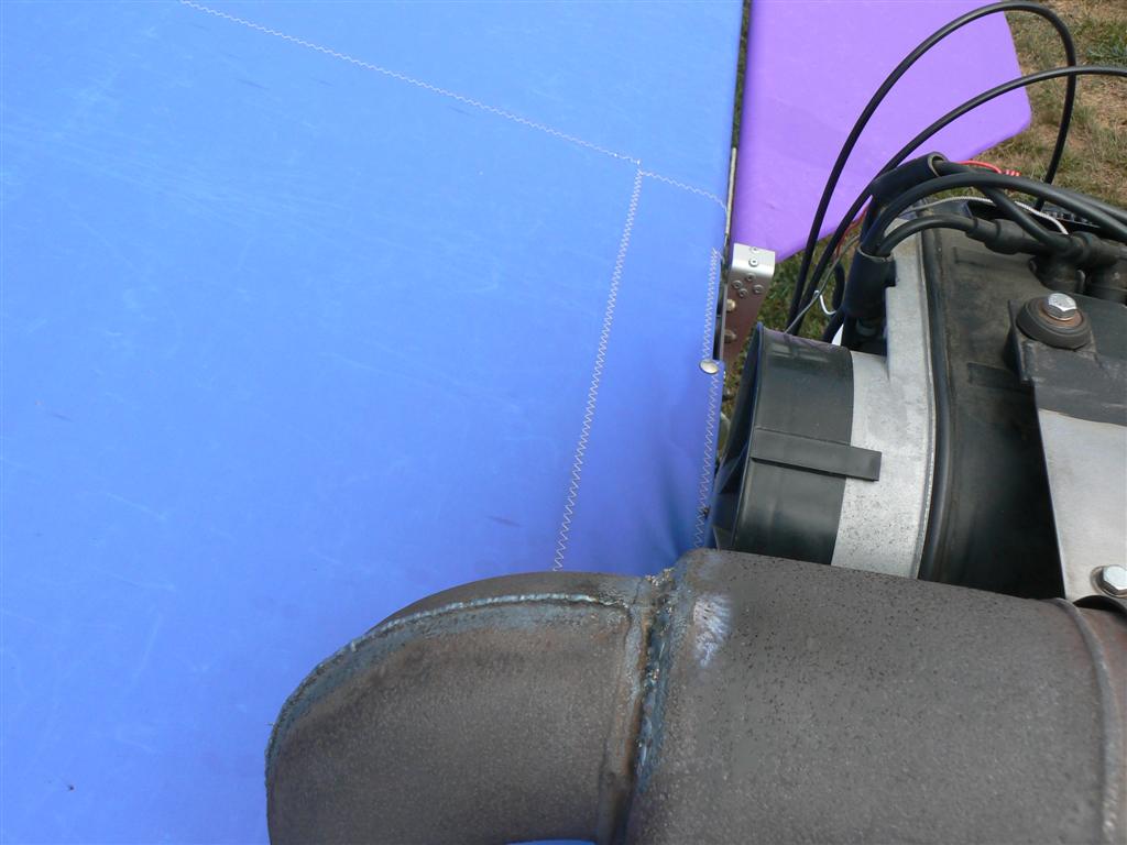

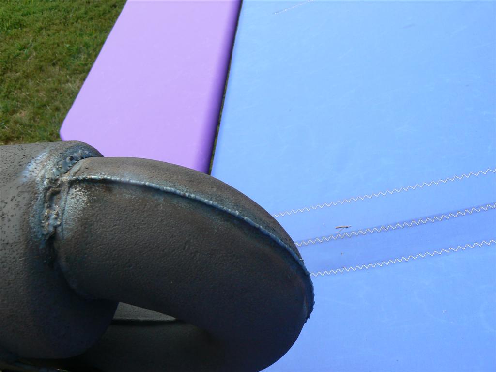

Today a friend flying a CGS Hawk dropped by and mentioned that his exhaust had been louder for the last couple flights, and he asked me to look at it. His was in the process of splitting, so we hauled out the welding tanks and welded it up while it was sitting out on the air strip.
After I got done, it occurred to me that maybe this is info that needs to passed along, so here are some pics. Would have been better if I had thought of the camera first, but our priority was getting him home safely.
I guess this is not specifically Kolb related, and this is only the third one I have seen in over ten years, but since a lot of us use this sort of muffler, I thought it worth passing on, maybe it ought to be a preflight item?
Not the prettiest welding job I ever did, but when you are standing on a stool, on your tip toes leaning over the top of the muffler and sweating like a hog - I don't care.
You can see where the split was - right up the stamped seam, and then where the expansion section ties into the can, it had split for a couple inches in both directions across the top. Welding that was pretty cobby, real thin stuff next to a thick section that was factory welded. Not even sure if I got all of it, but where I was standing, I couldn't even see it all. But it got him home safe, and he can always bring it back tomorrow in the trunk of his car if I missed a spot.

Richard- What kind of filler rod did you use on this? I also see a reinforcing strap going from the muffler to the inlet pipe. Was this a factory option at one time? Mine is all salt rotted and stress cracked. I welded some of the cracks with a flux core MIG, but I also have a torch, just no steel filler rod. Your welding looks pretty good from here.

Wow! several questions -
It was mild steel 1/16" welding rod.
I saw that reinforcing strap also, the current owner is not the builder, so...?

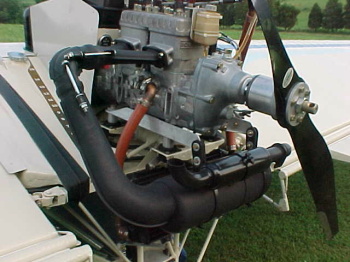

John - roger that on the pulses taking it apart, that is one of the reasons I went to the Quicksliver style exhaust on my current MKIII installation, it just looked less stressed. The curlyque style is also semi-cantilever mounted off the side, so I am thinking that the Quicksilver type down along the engine axis, ought to have less stress. I added a picture of it.
However the one on the Hawk was partly operator error in addition to the exhaust being old, he was doing a mag check a few days ago and inadvertently turned everything off, then promptly turned it back on, it made a loud backfire, and immediately the exhaust was notably louder.
