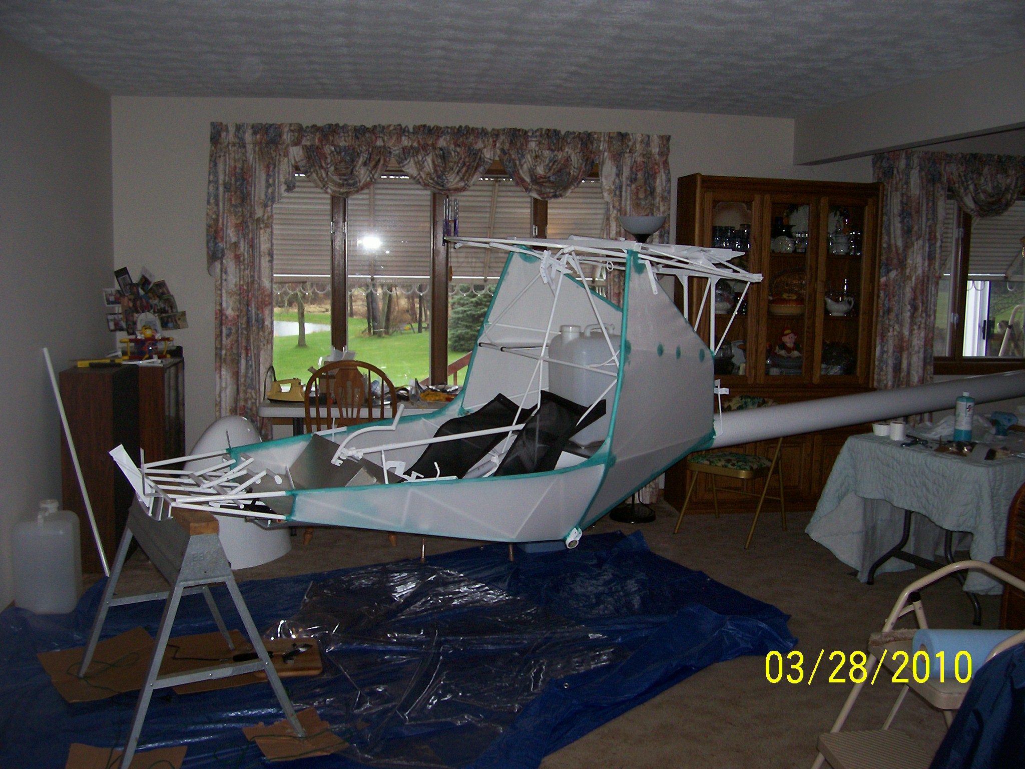

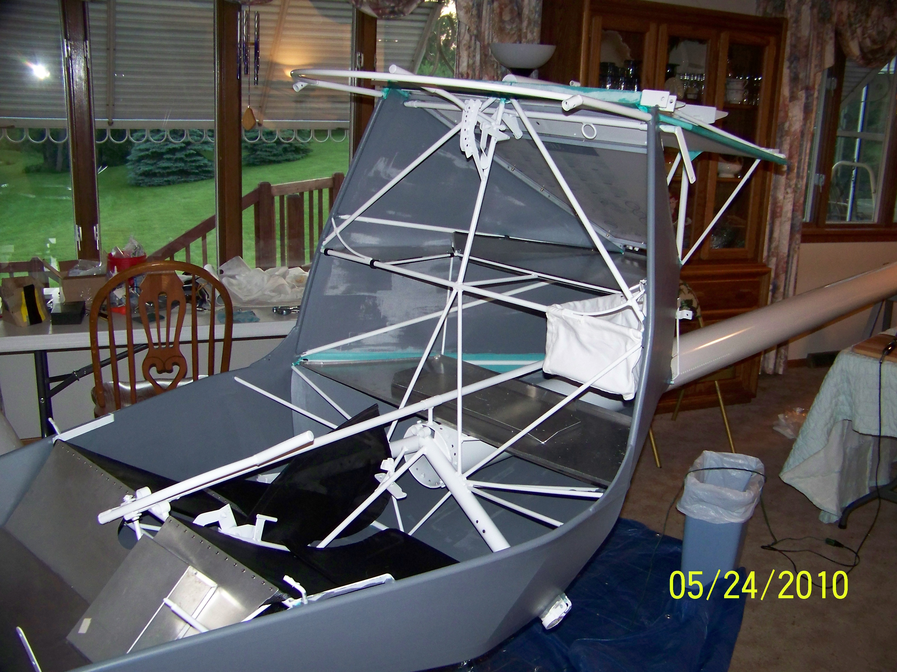

I am using Stewarts water bourne system to cover my mark 111c .I bought a Kolb kit that had been started and the fellow quit on it.Stewarts is faa approved and has no toxic fumes,also been around awhile.Glues will stay tacky and the cloth easy to work with and moved around till glue is recoated over seams or joints.Moved the plane into our house after New Years to do the covering.Double doors on front of house.Attached is a couple pics.Also did uv protection in the livingroom.Cost may be little higher but no toxic fumes to inhale or handle.The furnace never had to be turned off.No fumes!

Beautiful work, Gary. If you don't mind a suggestion from a 582 powered Mk IIIC owner/flyer, put in a one piece larger fuel tank now, if you can. 10 gallons is barely two hours of flight time with no reserve. It really puts a damper on leaving the pattern to enjoy your airplane. I'm sure Hauck will validate this view point. I know it's on my list for this winter when I recover the fuselage of mine. None of my business, but does "into our house" imply a spouse? If so, you are one lucky man. :-}

Thanks Rick,I have put Kolbs 6 gallon tanks in the plane.By raising the roof line in the back and putting a removable lexan window I can change out the tanks if need be.It also gave some storagebehind the tanks on an aluminum shelf across the upper tank framing that extends to the back.And yes there is a wife and she has been a great help and supporter of the project.
