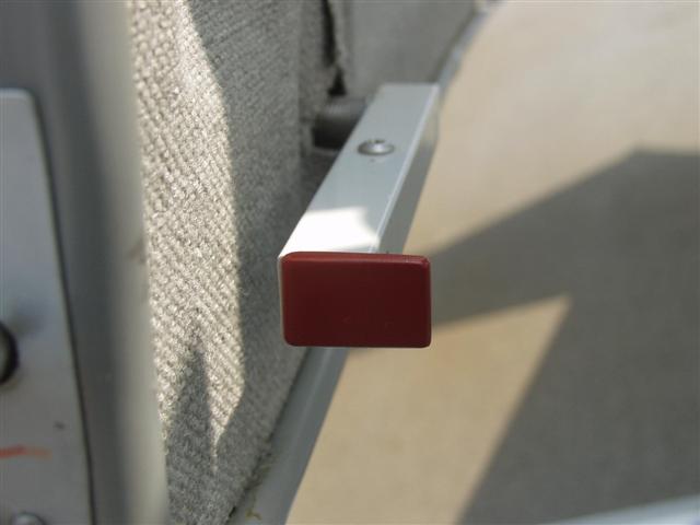

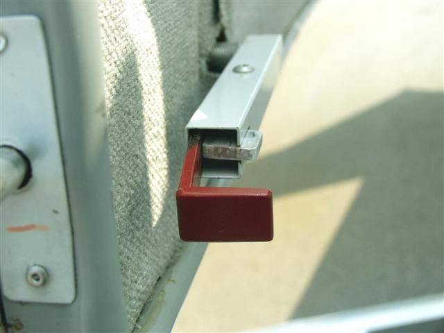

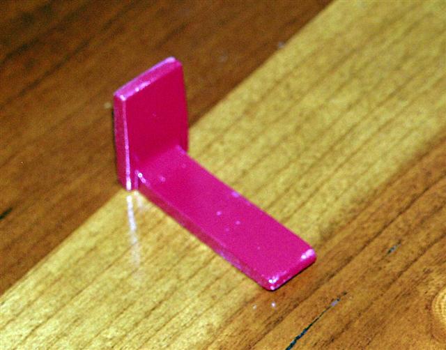

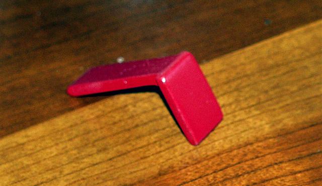

OK, here's another gizmo.
I got tired of trying to track down another same keyed lock for the passenger door (I'm not sure why Van's only gives you a keyed ignition, baggage door, and one passenger door -- and everybody is playing dumb about finding another lock to match the key number) ... so here's a simple and cheap solution.
It may have been done before but I just did this: The pictures are of a slice of angle iron with one leg trimmed to slide between the inner door handle (Van's stock handles) and the lock button, and the other leg is a little larger than the end of the handle so that it can be removed easily. All this does when inserted from inside the plane is to prevent the release button from being pushed from the outside (or the inside), effectively locking the passenger door. Then just lock the pilot door from the outside.
Done. Debate whether you want to fly with it locked or not, with or without large or small passengers, Wes won't.
Later, - Lew

Very simple solution, but through Aircraft Spruce I ordered 3 lock sets keyed the same as my ignition. Were they not able to help you?

I think your design is swift! I however just drilled a 1/16 hole in the
lock button and put a clip in there, does the same basic thing, but your
design is a lot more solid than my pin.. for sure..

Yes, I checked into the Lowe's /HD lock sets, but the keys won't match the ignition key. I left Wes to check with Van's about getting another lock to match the ignition -- he implied that their response was that it couldn't be done and nobody mentioned Spruce ... and I really didn't want to put another hole in a door anyway!

your solution is better anyway!

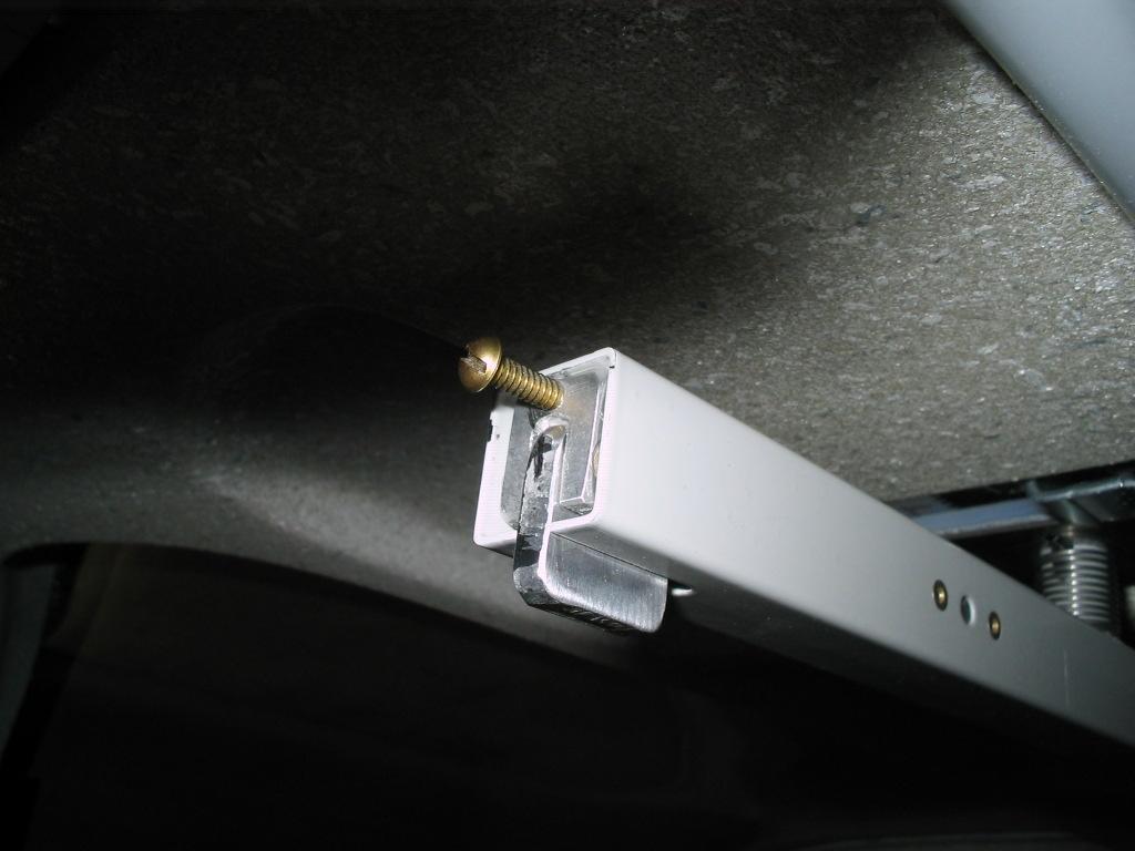

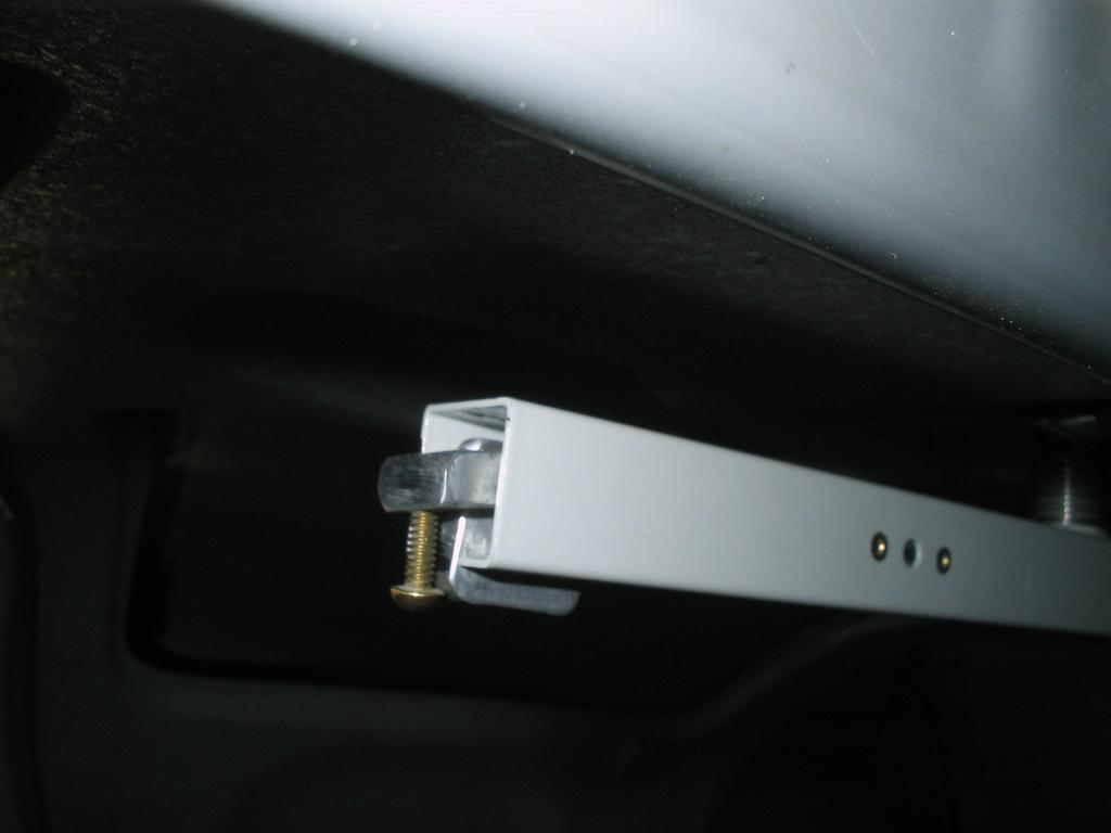

PostPosted: Tue Aug 17, 2010 8:36 pm    Post subject: Re: Door Lock Reply with quote
here's a slight twist on the same strategy. A block that is hinged to the release button so you can pivot it into or out of position and you won't lose it.
