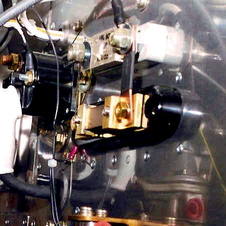

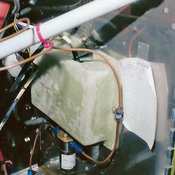

I looked through my collection of construction photos and found three that might be of interest. I made a cover of fiberglass to physically protect electrically "hot" components that had large exposed areas. My concern was more for protecting them from any possibility of conductive contact to airframe ground more than for protection from dust or oil vapors. The two components protected were an ammeter shunt and an ANL 60 fuse to the output from the alternator. Both of these were at battery positive potential when the master switch was closed.
I made the cover of fiberglass. It had openings on two sides: to the alternator, ammeter and the master contactor. I attached it to the firewall with screws and nutplates.
There are three photos, one of the components uncovered, and two of the fiberglass cover in place. The cover was later painted.
I hope this is of some help.
Best regards and good luck,
Richard Dudley

rhdudley1(at)bellsouth.ne
PostPosted: Sat Aug 14, 2010 8:22 am    Post subject: Firewall Hot-Side Enclosure Reply with quote
Jared,
No problems over 140 hours over tree years flying mostly in Florida.
Rich
